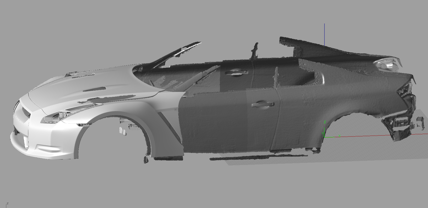

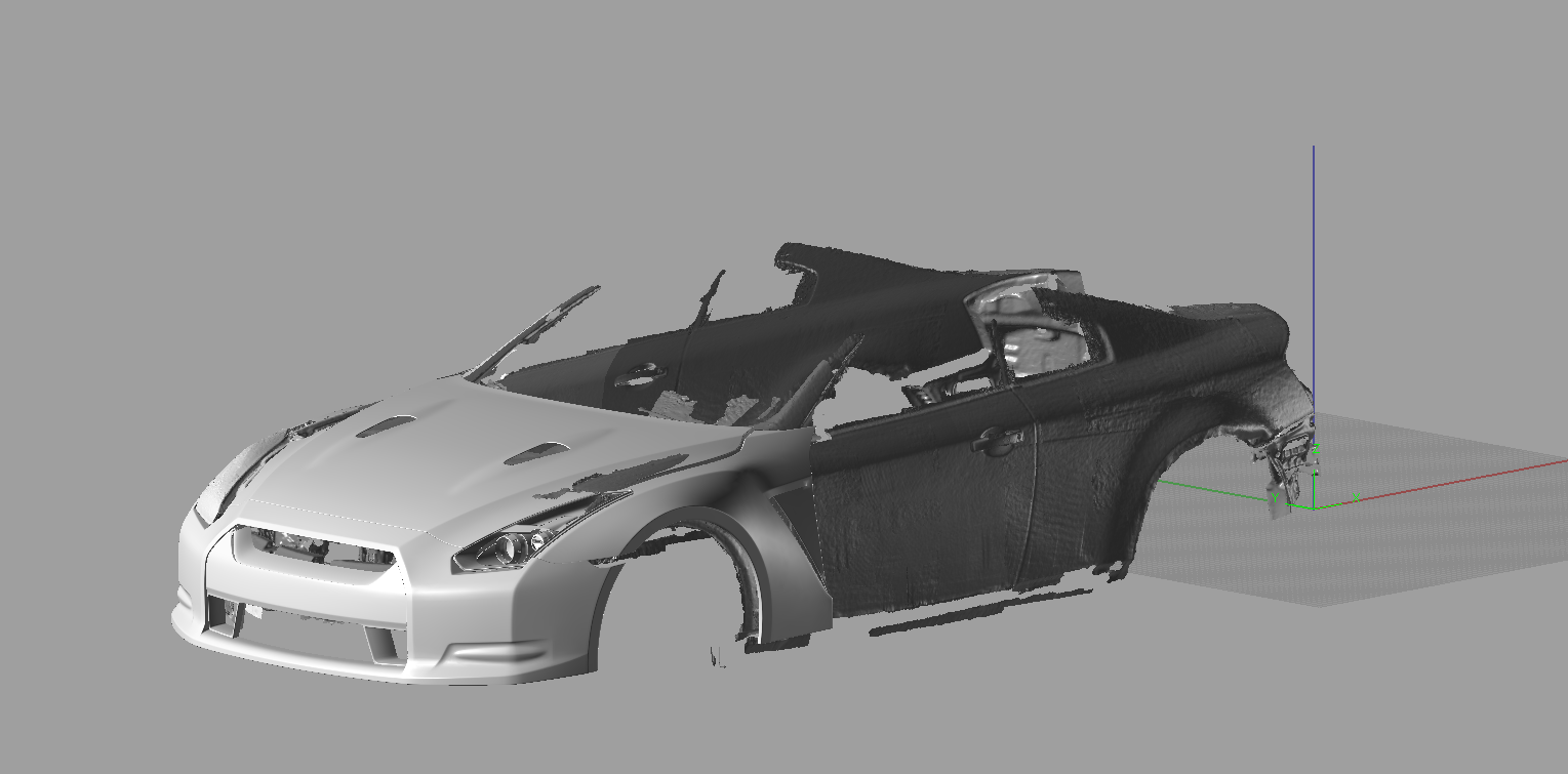

Hope everyone had a good holiday. Got back to work. The next thing was to check the scan to see if it was accurate and it is indeed accurate. Next, I mocked up the front end of the GTR to the g35 scan. here are some photos. The front end looks good but a tad bit big? anywho its surprising how well it fits to the g35, do both cars use a similar platform? one of the tabs on the gtr headlight bolts on in perfect position to the radiator support, maybe its just luck. thats all for now. The 3d modeling process is pretty slow and will take about a week -2 weeks to complete.
