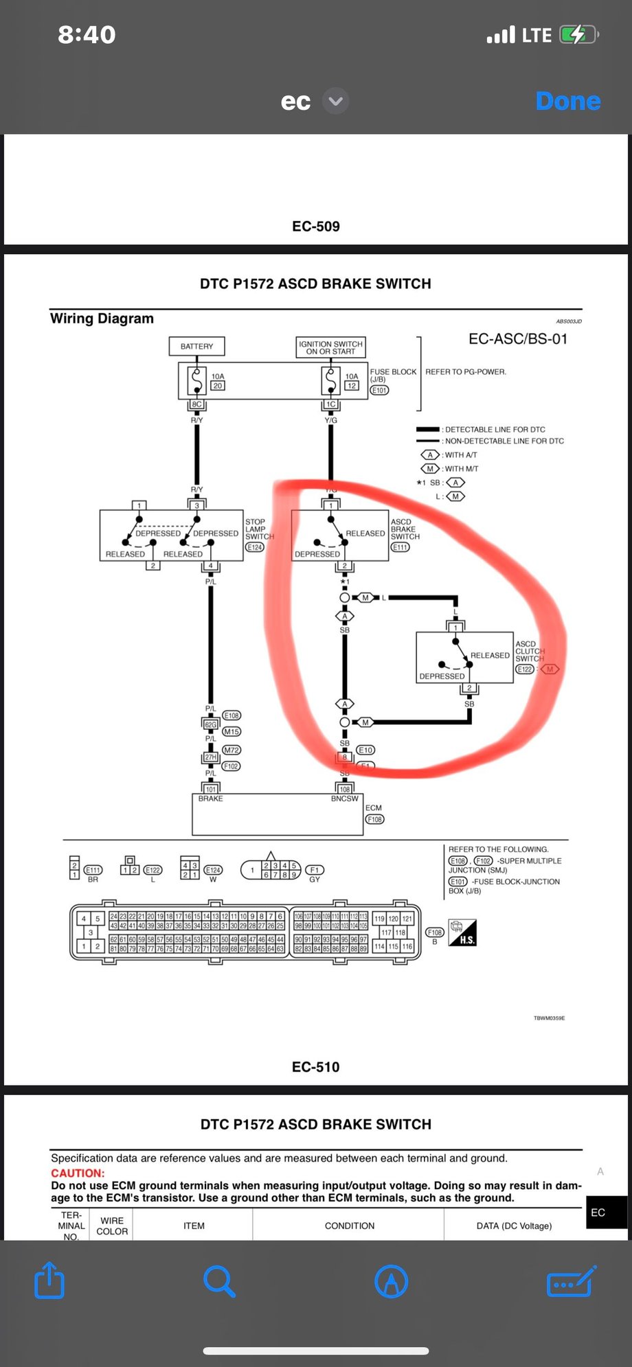

This thread has been a real life saver and has given me a lot of knowledge of the wiring required for a 6MT Swap.

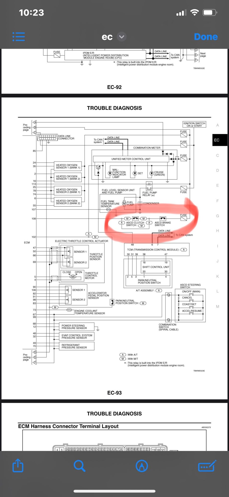

However I’m curious on the one switch that no one ever speaks about… The Clutch Cruise Control switch.I looked up the wiring diagram for the Clutch Cruise Control switch and I believe I figured out how to wire it but just wanted a second opinion.
According to the diagram it looks like the Clutch Cruise Switch runs in line with the already existing Cruise Control Switch on the brake pedal.
So is it just as simple as tapping into the already existing wire for the Cruise Control Switch on the brake pedal or is there more to it ?
Any help is appreciated.

No it's a series circuit on the 6MT, see that little line has letters on it
A - is the wiring for an automatic transmission
M - is the wiring for the manual transmission
6MT power goes through the brake pedal ASCD switch, then to the one on the clutch pedal, then to the ECM. This way touching either pedal will kill the cruise control.
