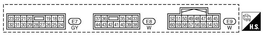

I have a 2003 350z that the wires have pulled out of the E7 connector. The ipdm is the same as in a 2003 G35. I am trying to find a diagram that will show me which color wire goes onto which pin

Hopefully someone can snip out the 2003 IPDM layout from section PG of the FSM, Here's the one for the a 2006 coupe which might help? Green/Yellow is what the color is listed as AT the IPDM, That's for the ignition switch correct?

Probably. This all started from replacing the AC compressor. Short version, I was tracing the Compressor Clutch power wire through the harness looking for a physical break. In the process, all of the wires for the E7 plug have come out. I am hoping someone has a wiring diagram, or knows which wire corresponds to which pin. Apparently, had I had this problem last month, I could have accessed the FSM myself. Thanks Nissan.
