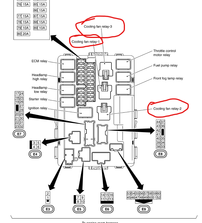

There are 3 relays in the IPDM for the cooling fans, swap them around and see if anything changes, they're all the same relay.

I was wrong about the temps for turning on low/high, here's a snip from the FSM, it's in section EC under "overheat conditions" also is a snip of the IPDM layout, section PG and somewhere in the middle.

Usually it's the fan motor itself that failed but you should swap relays to make sure, label them 1,2,3. First swap 1 and 3, the swap 1 and 2. If it's still doing the same thing you need a new fan motor.
