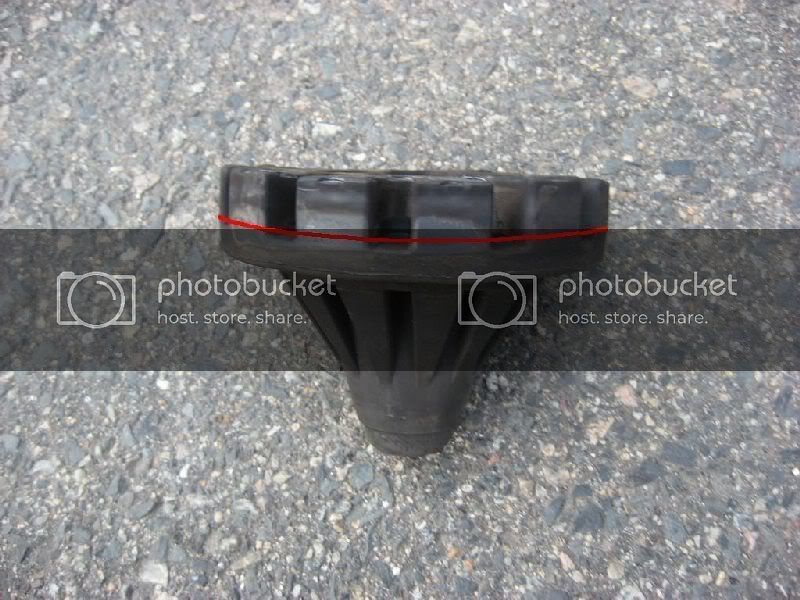

Correct the 350Z springs only drop the front, the rear is easily dropped by chopping down the large rubber spring seat at the top of the spring perch.
Old Oct 30, 2020 | 04:19 PM
cleric670's Avatar
BANNED!!!
Joined: May 2017
Posts: 14,837
Likes: 2,497
From: Washington State
Coupe 6MT Premium RAS
Basically you just take 1/2" (or more, up to about 1" if you want to go that low in the rear) off of the top of that rubber stopper then reinstall it.
