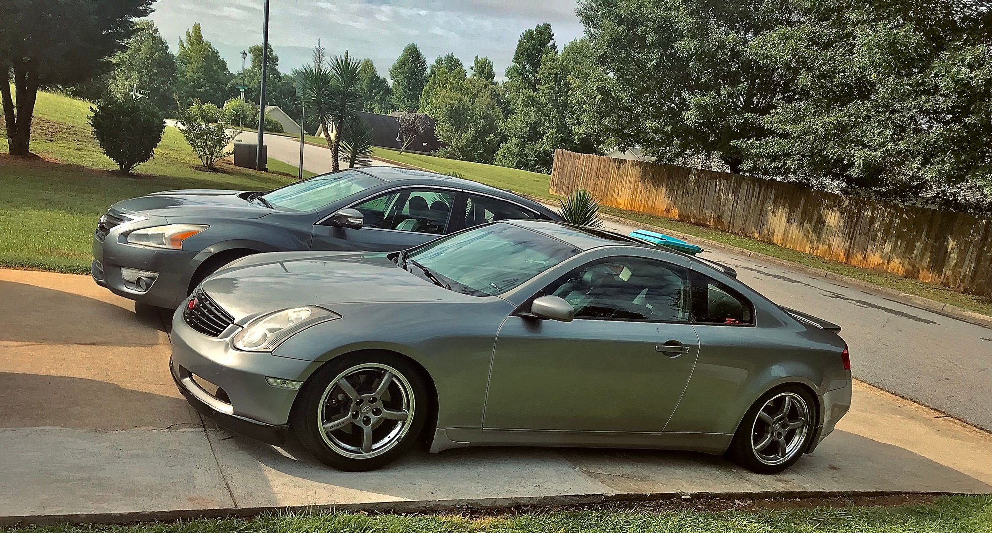

Eibach sportlines on a 07 g35 coupe worked out perfect for my suspension.
Got about 2.3” in the front and 2.0” in the rear also did a complete front end poly bushing overhaul on the front end. Eibach sportlines model number 4.6463 originally for 350z but someone mentioned it was a lower drop with the 350z eibach kit the then g35 kit! Oh and reused the stock g35 sport strut. Came out awesome, rides great!
Old Jul 12, 2021 | 05:55 PM
Chutiya's Avatar
Joined: May 2021
Posts: 28
Stock G...Just lowered
Your ride looks sick.
