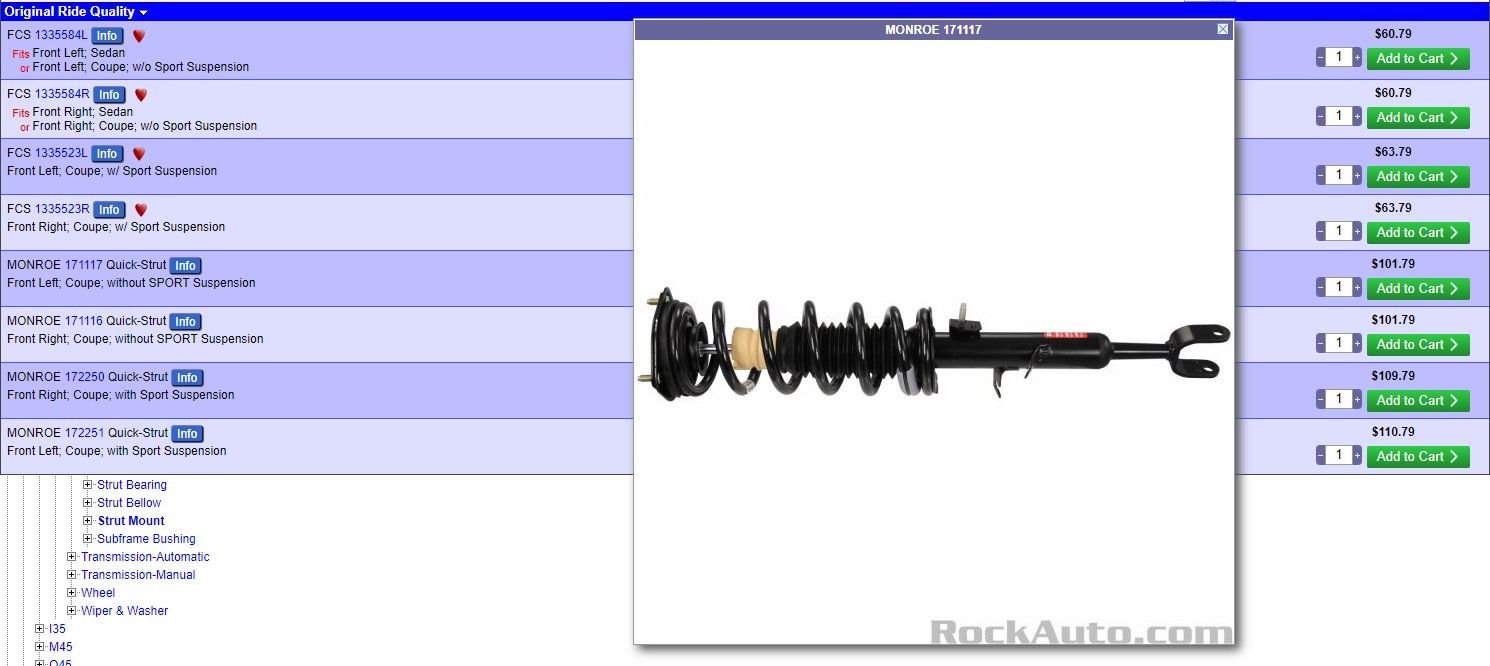

Did you try Rockauto?

Yes, Rockauto had the backs but not the fronts.

I didn't even think they made them for the rear since the springs aren't attached to the shocks as the front springs are to the strut.
This isn't what you're looking for?
