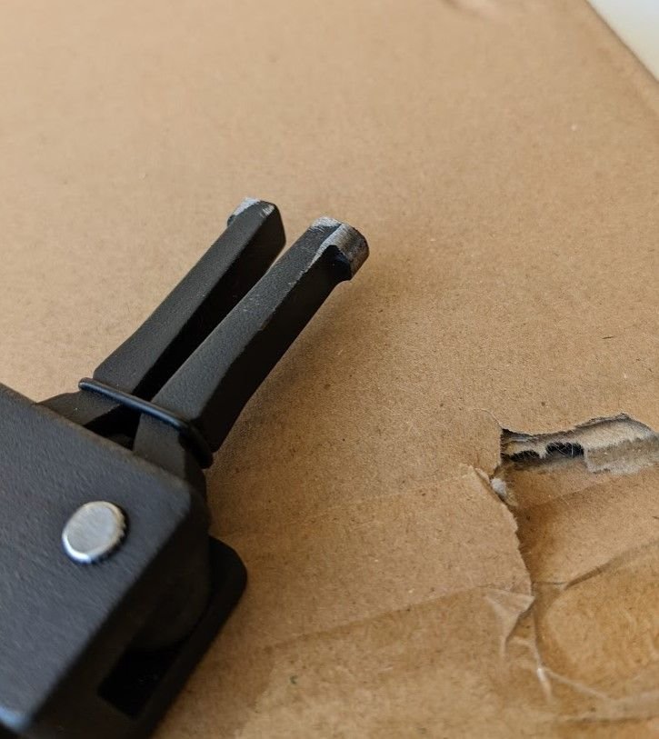

What you linked is a collet puller. The problem is the inside edge that is supposed to grab the back side of the bushing is TAPERED instead of being flat.
That other puller OTC 4579 has a nice sharp 90 degree with no taper, it locks well onto the inside lip of the existing bushing.

Weird, my pictures didn't upload or something, and my entire post seems to have vanished. Here they are again.
In the first pic I drew an arrow to the most important feature of this pilot bushing removal. It's that hard 90 degree angle that's not tapered. That grabs tightly against the inside edge of the existing pilot bushing. Then you can slide hammer to your hearts content to pull it out, just don't overtighten it and wedge it up against the edges of the crankshaft. Just barely remove the play but don't actually TIGHTEN it once it's set in place, you should still be able to move it back and forth.
EDIT: Found them, put them in the wrong post... here's the text of that post.
If you look in this first picture, the top down one, you can see that the edge that grabs the bushing is almost a true 90 degree corner. Collet pullers are all angled, thus they actually WEDGE the bushing in tighter...
For the application they're typically used for though, pulling BEARINGS (not bushings) they work great though. If you use a collet puller on a BUSHING (single piece of metal without the movable pieces) then you will almost always end up slicing through the side of the bushing so it can collapse a tiny bit.
A BEARING doesn't need to fit very tight against the outer race because you're rolling on needles or *****, a BUSHING has to fit extremely tight so it won't spin the outer race.
