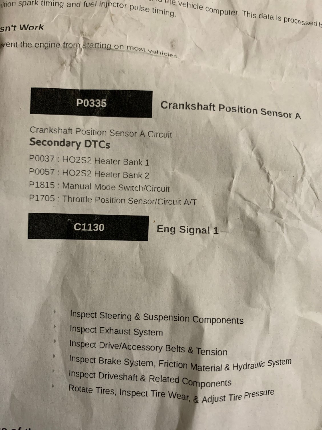

No just my crankshaft position sensor A but my secondaries are my o2 sensors didn’t get them welded in yet ,manual mode switch/circuit and throttle position sensor/circuit A/T

I’m going to check the wires to the crankshaft if that isn’t the problem I will switch to OEM parts
CODES BELOW 👇🏾

I believe Hitachi is the OEM part maker. Check out Nicoclub and look up the FSM for your car and you can get better understanding troubleshooting tips. Your car does run though right? I think there are three wires on the sensor one should be ground, one goes to IPDM, and the other to the ECU. I am wondering if maybe that P1705 might be causing those lights to come on too.
