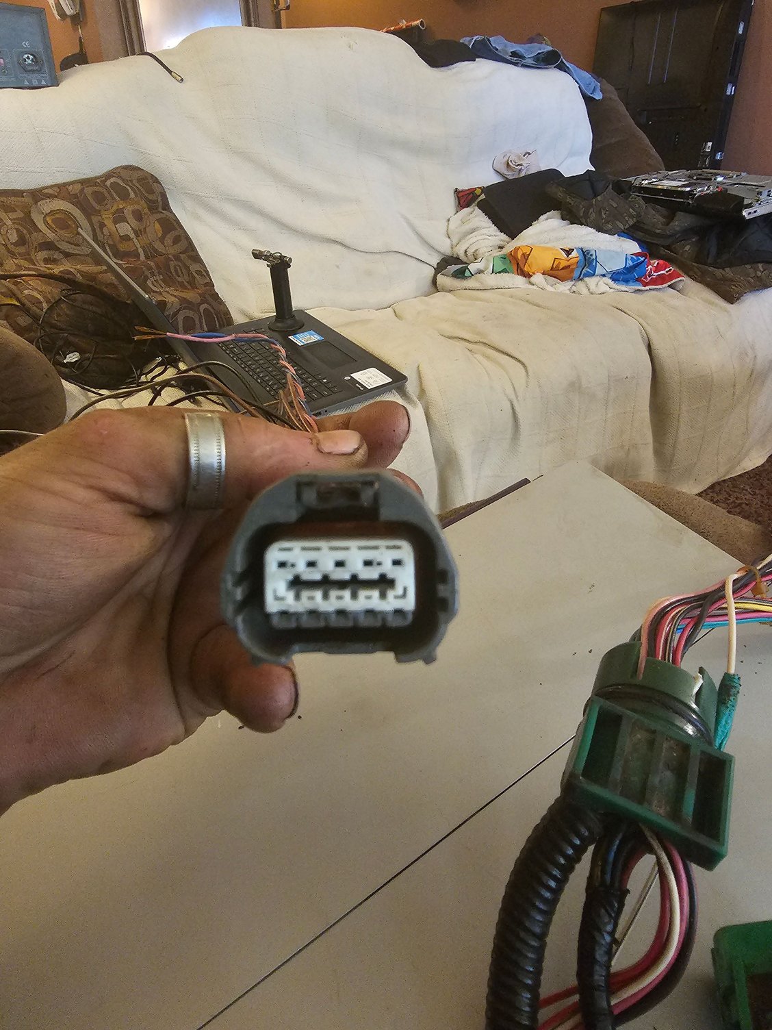

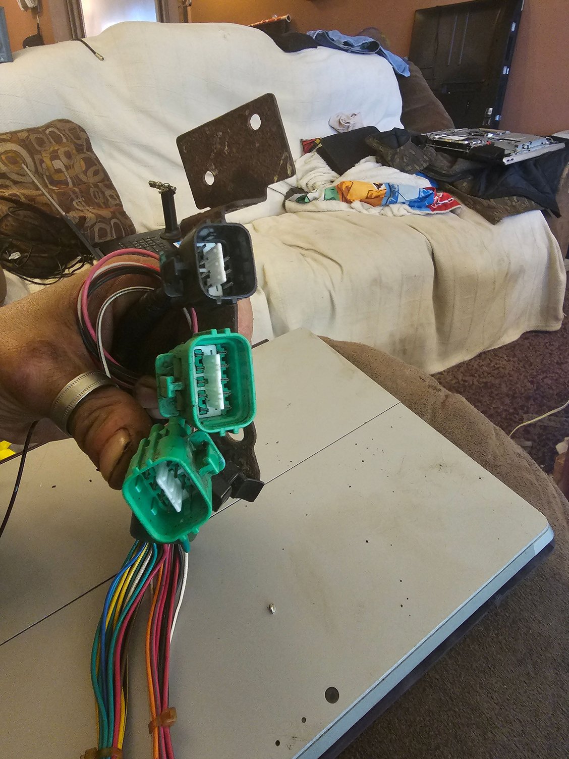

not sure if im in the right spot here but i recently bought an 2003 g35 sedan that was stuck in 4th gear and the manumatic didnt work. was told it just needed the tcm replaced (or just the whole trans. so after just taking out the tcm to look it overclean it up, throw it back in. still the same thing only now it doesnt move at all.
long story short ended up cracking the valve body at some point later on dicking aound with it. so i just went and got another transmission. come to find out the new trans valve body plug on the trans is a single connector. as the old transmission valve body connector has 3. (as seen in photos) can i just frankensplice these to use the single connector so i can use the trans? if so i need to find a the info on what each colored wire goes to what other wire.

The harness in the photo is for the older transmission that has the TCM mounted in the cabin next to the ECM. The newer transmission has the single large plug and the TCM is located inside the transmission, I'm not aware of any way to swap from one style transmission to the other because there's a lot of chassis wiring involved getting the TCM moved from the cabin into the transmission housing. Technically it's possible by creating a new bypass harness, I've just never heard if this being done, ever.
The valve body itself uses a different harness too and I don't think they are interchangeable, the only part that's usable off that second transmission you bought is the gears/housing/clutch/etc. You could pop out the grommet from the harness and install your existing valve body/harness into that second donor transmission.
That doesn't help you though if you have a damaged early model valve body.
