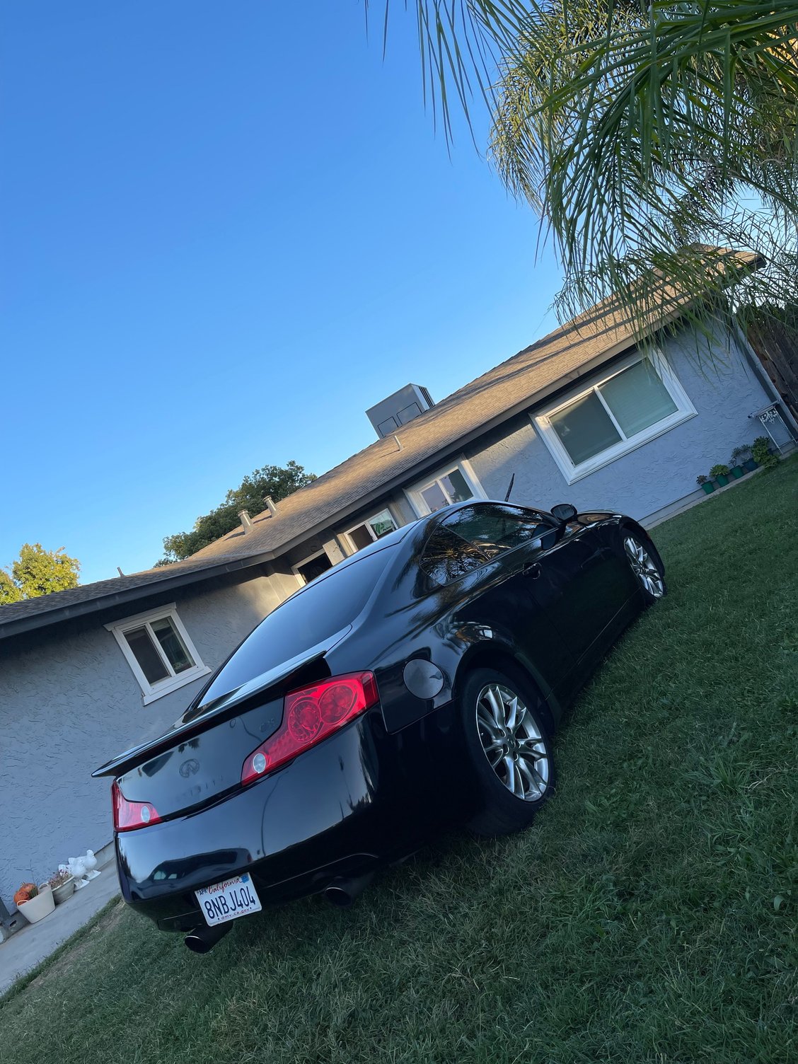

So i just bought my first g35, its a manual coupe and after about a week of daily use check engine light turned on. Upon scanning it got a random missfire code p0300. Initially i thought it would just need new spark plugs, coils etc. after changing the oil and taking off the spark plugs off, they were still in good condition expect for the cylinder 6 one which has oil around it and on the coil tubes. Could this be what is causing the missfire? How should i go about this? Should i replace the valve cover or just the ignition coils?
