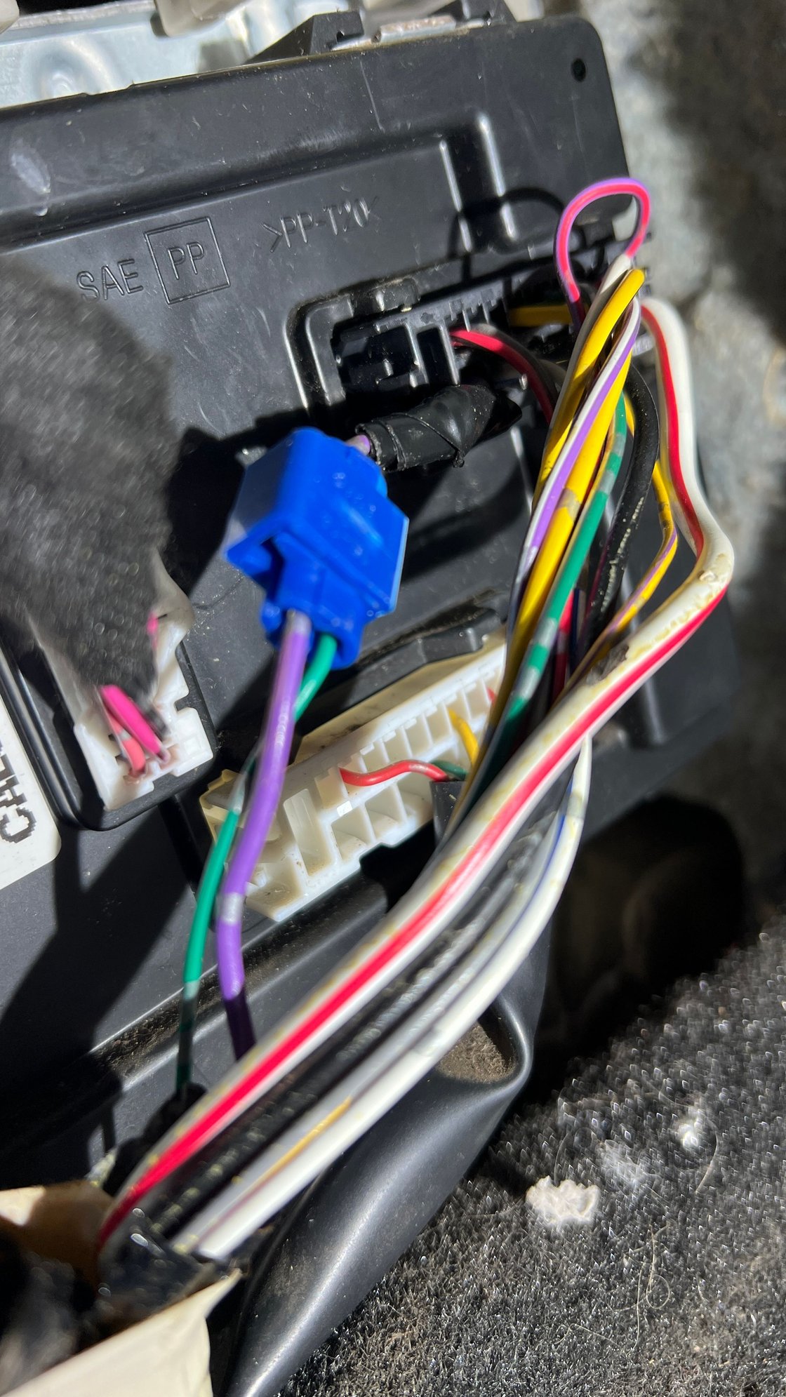

if not familiar, this PDF and two videos is what they give you for instructions on how to install. I’ve installed it correctly (I think), but now the engine only turns over and won’t start.
as per the PDF, I have attached to the purple wire on the white connector of my BCM. I’m here just to verify that the purple wire is the ignition wire that the trigger should connect to. I have all the manuals including the BCM manual for my G35, but it doesn’t give a color coated pin out
Any and I’ll help would be appreciated!

Remote Start Trigger Wire scotch locked to what 12volt.solutions claim is the correct wire to connect to

Does that kit come with some kind of immobilizer bypass? My guess why it just cranks is that the immobilizer is preventing it from starting. I don't know what kind of indication you should get if the car doesn't sense the key fob. Maybe a red key light on the combo meter. When I had my car tuned, I had them disable the immobilizer so I wouldn't have to mess with that and to eliminate the possibility of any future problems with flaky immobilizer and key fobs.... made the remote start install easier.
