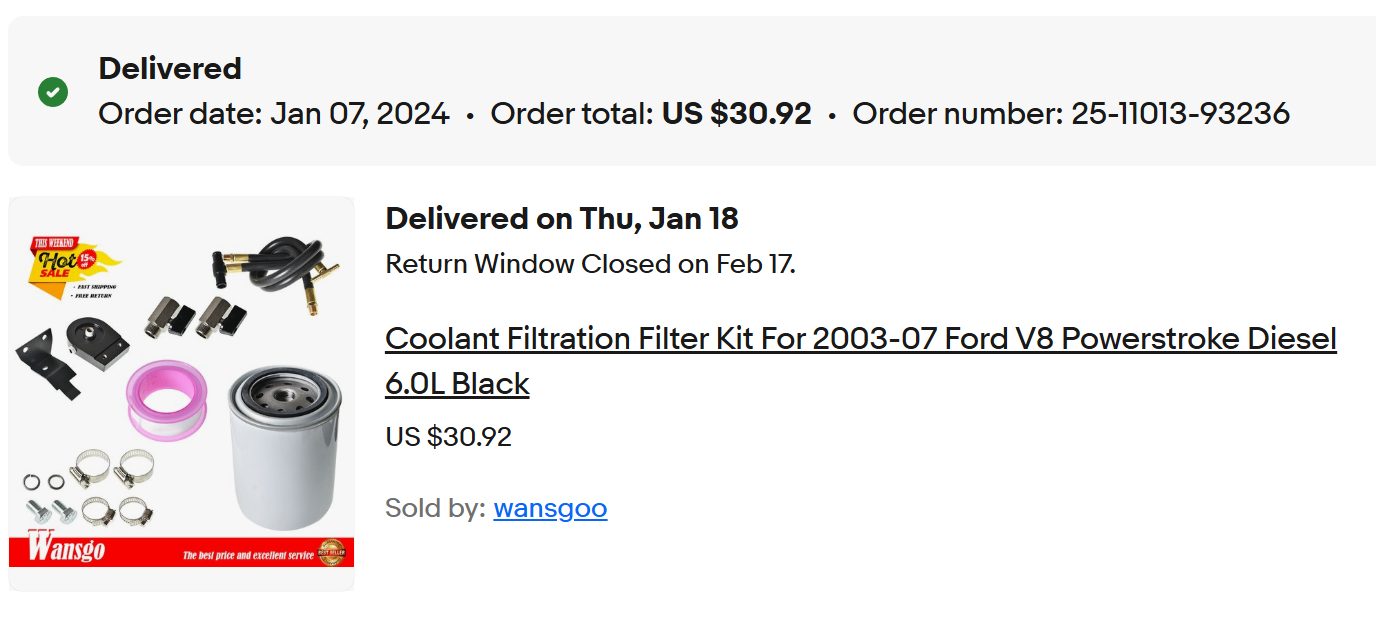

I bought a 2015 Jaguar XFR-S from auto auction from Texas and it arrived with a very sparkly and flaky coolant.. Some moron dumped a can of 'leak-fix' into the coolant and the issue was a rotted away cheapo plastic Ford crossover pipe in the back of the engine (i have all that crap on video in my youtube channel). So what i did was buy a coolant filter system for a 6.0L Ford Power Stroke diesel and rigged it in there to clean the coolant. I bought it a while back and today, those go for around $50-$70. Filter is WIX 24070. So 2 filters and 250 miles later, no more sparkly flakes!
I did the same process in my G and my 05 Town and Country. Coolant does get fouled overtime and if the previous owner ran on water, then theres gonna be bunch of crap floating in there and most likely, stuck in the heater core.. It's always a good idea to back-flush the heater core using a garden hose, you'll be amazed what comes out of it..
