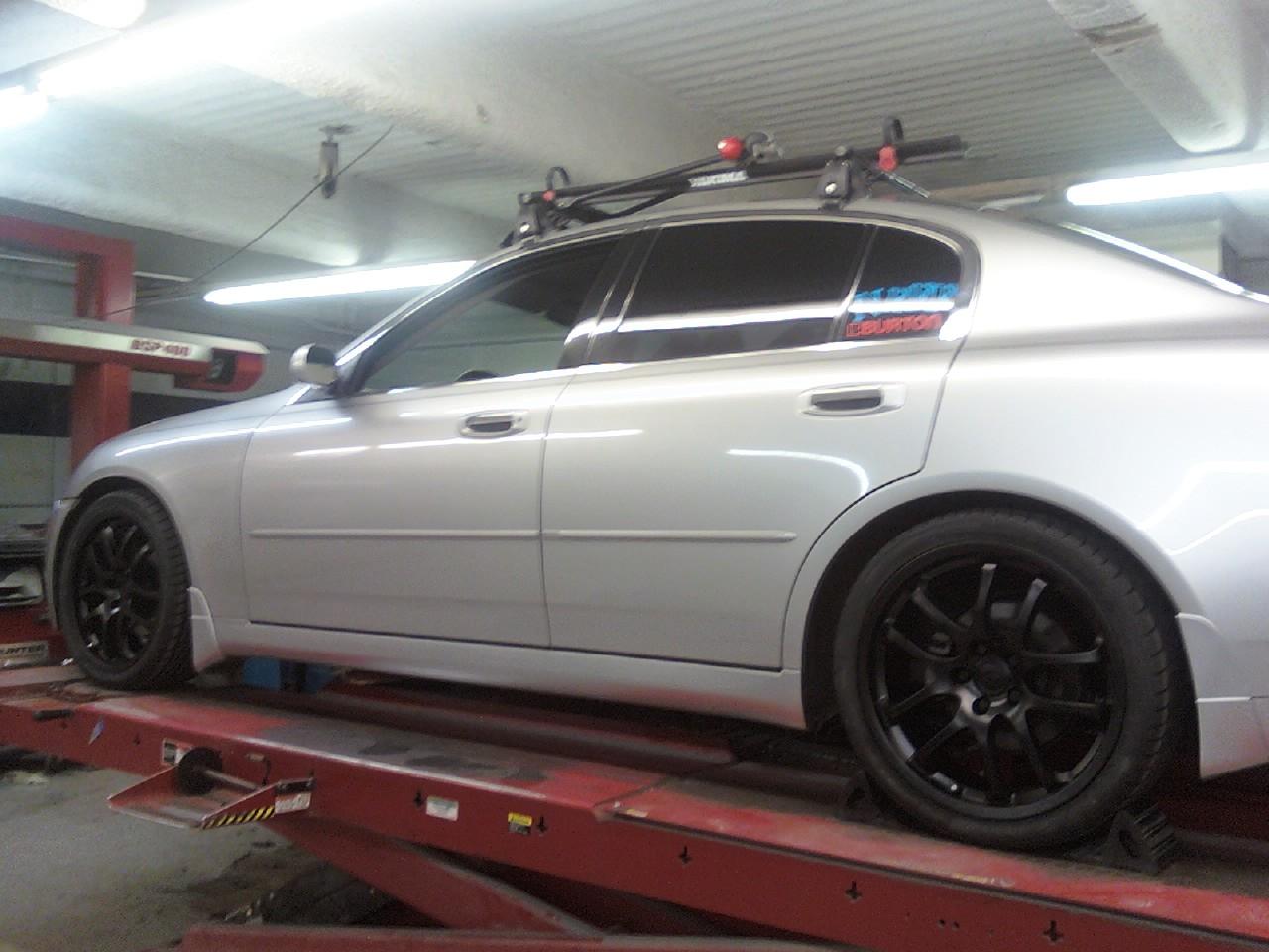

finally got my wheels and springs on. 04 350z springs on the front and stock on the back due to heavy subs. probably get smaller sub and coupe springs on the rear.

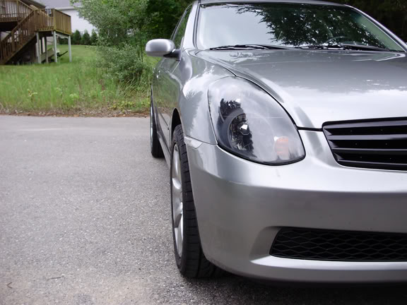

I live in snow country too, so I'm not going to drop my X more than ½"-1" total. Here's a side shot of mine with 245/45-18's on Coupe 18's, stock suspension.
I measured the tire gap with new tires on stock suspension, and there's 1.875" in the back and 2.5" in the front. I'm going to drop mine with Sedan Sport springs in the back and Coupe springs in the front. Should give me about ½" drop in the back and 1" in the front, and should make the tire gaps almost even (1.375" R and 1.5" F). I don't want anything more than that because of the winter driving and I don't want to buy a camber kit. If you drop too far, you'll have to roll for sure. My fronts are just a tad ouside the wheel well.
BTW, get 245/45's. There's a far better selection of tires available. 235/45 is an odd size. I went with Bridgestone RE760 Sports, but they're only for summer. I have Nokian WR G2's on my stock 17's for winter.
