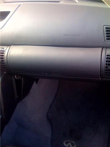

how can i fix this

how can i fix this
How can i get this back to normal. i think the glue is coming off. i have a sedan, anyone else have this problem, how did u guys fix it.

I'm not sure on the actual fix. But whenever you get if fixed, let us know what you did. My dad's '03 Sedan is doing the same thing...

happened to me.....
went to the dealer, replaced the whole lid. Didn't even try to fix it myself.....

I Repaired This On My Buddy's 04 Sedan. Required Taking The Entire Under Dash On That Side Apart, As Well As The Center Console To Extract The Cubby Where The Lid Is Attached. Once You Have That Out You Can See The Screws That Need To Be Removed To Access The Lid Better To Glue It. A Strong Apoxy Type Adhesive Will Do. To Find Out How To Take Apart Everything To Get That Cubby Out Refer To The Diy Section "bythabay" Has Videos. Double Din Video And In-cabin Filter Replacement Videos Combined Showed Me How To Disassemble Everything.

If you are still under the bumper to bumper factory warranty than take it to the dealership.

whatt. lol i just went in today and they were like you have to get a new one, which will be expensive. i have extended warranty from a third company which doesnt really help me in anything.

hey thanks man. this sounds like a project.
