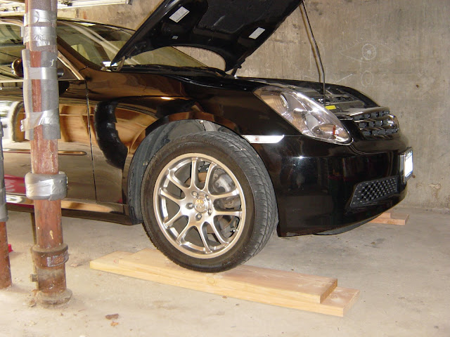

Another option for the OP is to build some simple ramps that get the car up 2-3 inches, enough to get his jack under the front center point. I used a 4 foot section of 1x12. I cut it in 3 pieces, roughly 11", 15", and 20", at a 45 degree angle, stacked, glued, and screwed. Smoothed off the 45 down to about 30 and sprayed the bottom with some PlastiDip so they won't slide on the floor. Gets me 2.25" of lift when I'm on them. You could add a 4th layer to get to 3".
You know what... as stupid as my post might have sounded, I'm glad I made it. That suggestion above is pretty much all I need. I think the extra 1-2 inches will be enough, and I have some wood pieces I can drive onto. It's funny how sometimes you totally don't think of the obvious and look for something more complicated. Thanks again!
