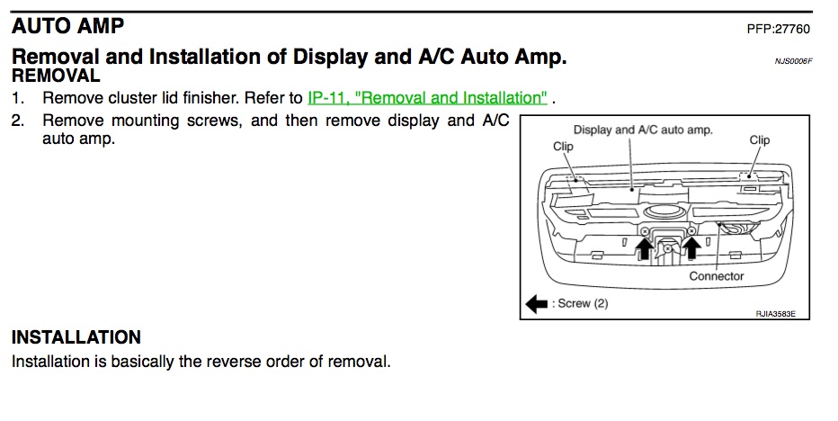

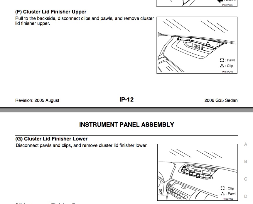

this is for '05 / '06 but it's what I've got...
Attached Thumbnails Clock Light-step1.jpg   Clock Light-step2.jpg   Clock Light-step3.jpg

Replacing the bulbs is super easy. I did this just a few weeks ago and used $1.70 in bulbs (Part 272-1092 #7219) from Radio Shack. They're smaller in diameter than OEM, but they fit in the light socket fine. I didn't put the yellow bulb "condoms" back on because I wanted as much light to shine through as possible.
