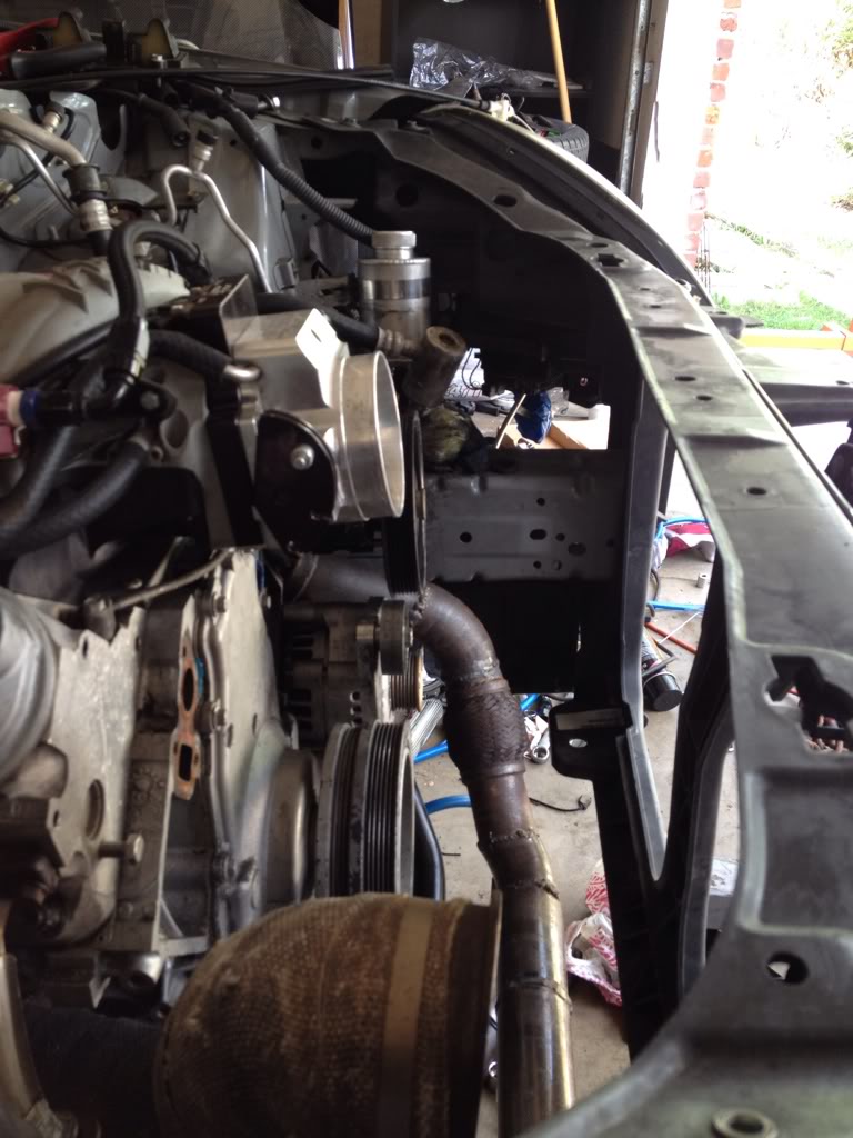

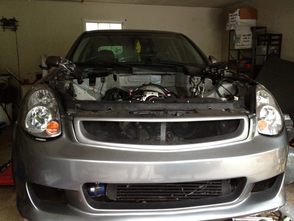

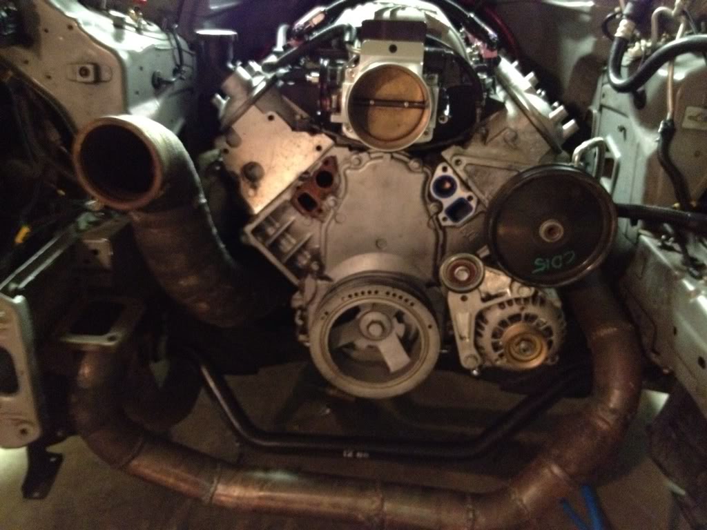

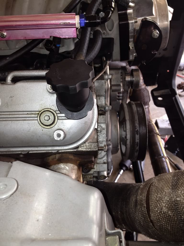

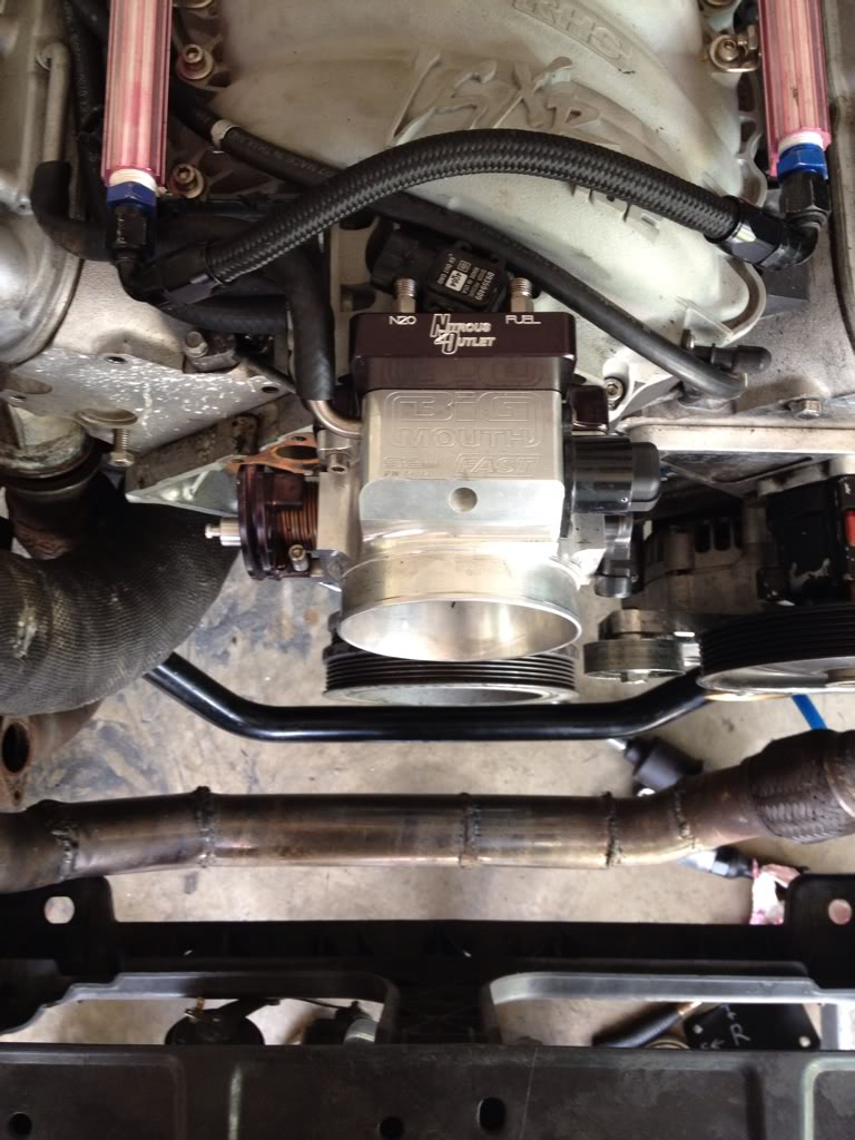

Short update. Doing some mock up making sure that SnyperZ from my350 LSX turbo kit was going to work with my setup. I ended up ordering a precision 7675 turbo with a 1.27 AR exhaust housing.
Here are some of the mock up pics i took tonight. Im going to have to make a new passenger side mount to go around the huge 4 inch downpipe. Im also going to have to go straight out with the water fitting off the of the water pump.

Short update. Doing some mock up making sure that SnyperZ from my350 LSX turbo kit was going to work with my setup. I ended up ordering a precision 7675 turbo with a 1.27 AR exhaust housing. Here are some of the mock up pics i took tonight. Im going to have to make a new passenger side mount to go around the huge 4 inch downpipe. Im also going to have to go straight out with the water fitting off the of the water pump.

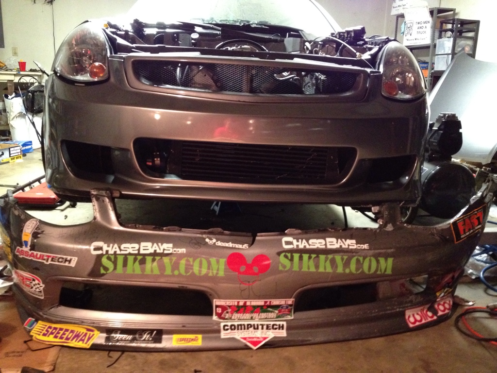

Scored a used DG kurookie for the low low yea i would say i needed a new front bumper

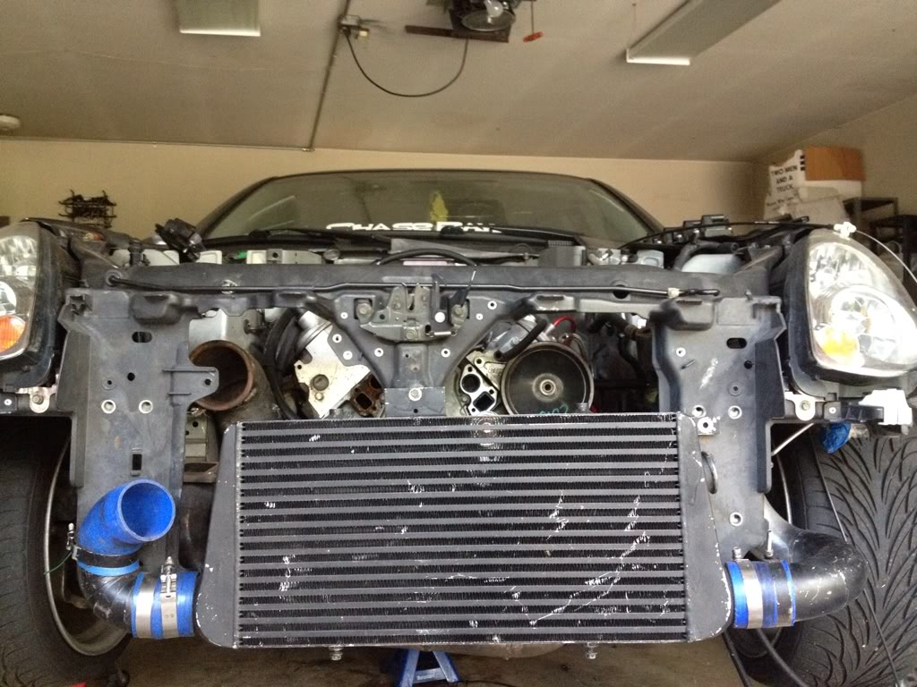

Have all of the turbo kit mocked up just waiting on my new precision 7675 CEA with 1.27 AR housing that is being ported to a 1.31 by www.afiturbo.com
