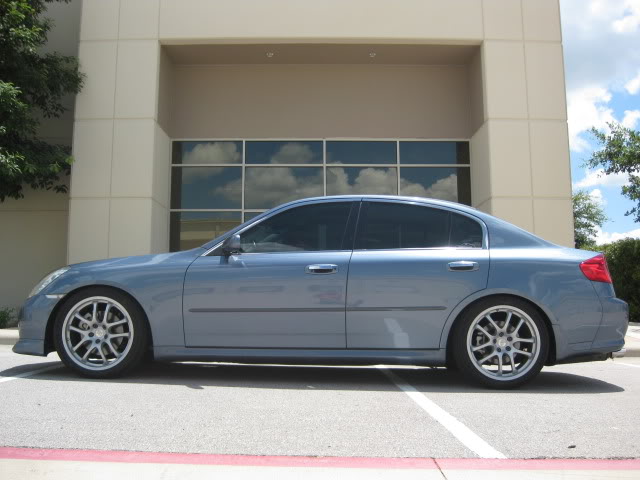

Here's a pic of me dropped on sedan S techs. I was also running z struts/shocks and the ride was a little harsh and stiff, but the drop looked good and even. Can't comment on the sagging, I didn't have them on long enough to find out.
