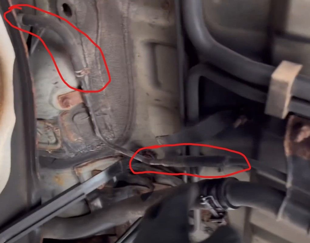

Those rubber hoses are accessible from under the car without removing ANYTHING. They're directly above the differential, it's sort of a tight fit to reach up to them, you'll probably need some angle head needle nose pliers to get the hose clamps off. I would focus solely on the SMALL line though, that's the vent relief one, it's on the same side as the great big hose for the fill neck.
There's a rubber coupling about 18" away up the line towards the fill neck, you can take that one off as well and blow brake cleaner/air both ways up and down the line after you disconnect the rubber 90 degree fitting from the tank.
This hose I circled is usually the problem, inside the tank there is a baffle which might also be an issue but blowing air directly into the tank from the rubber line can dislodge any debris. Your fuel pump sock/screen will catch any piece. It's a total pain in the *** to get your arm inside the tank to replace that baffle, I don't have very large diameter arms and it's an EXTREME challenge for me, people with bigger arms it would be impossible. I have to go all the way almost to my shoulder to reach the thing and it's a contortionist act to do the baffle swap.
Just make sure your gas cap is open if you go blowing air into the tank, and have less than 3/4 of a tank of fuel, preferrably less than 1/2. That air needs to go somewhere.

In that first pic the diff is removed, you can reach up around it to get the hose clamps off though.
