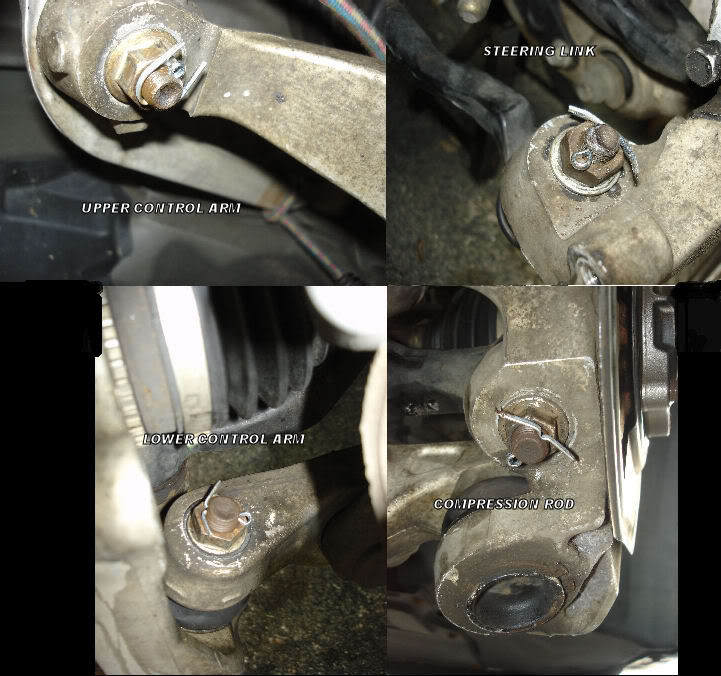

Here's how far it protrudes on my car

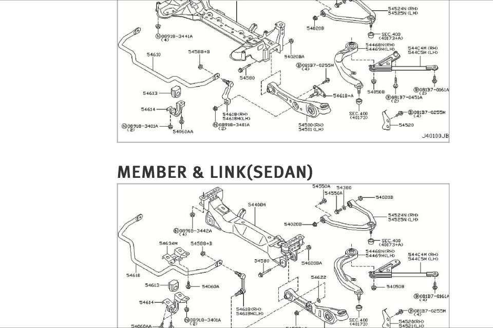

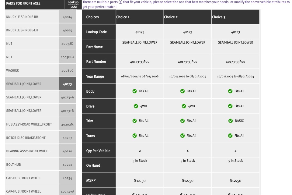

I looked online at the parts breakdown for the front suspension on the sedan. It shows the seat as part (40173) in sec 400. When you look up the part number for seat it gives 40173-33P00, which I received from Nissan. Now I'm confused because I seemed to receive the correct seat but it was different than what was in there. Other seats listed on there but for upper control, lower etc.
Does anyone know the part number for the correct seat for AWD comp arm?

Illustrated pic. Sorry Doing this from an iphone. They show the same seat for both AWD and 2wd for the sedan

I'm convinced they are not the same. I've seen similar things done on cars to prevent incorrect components from being installed on the assembly line. There is a difference in the AWD and RWD compression rods and I assume the different seats is a way to prevent improper installation.
Just a theory
