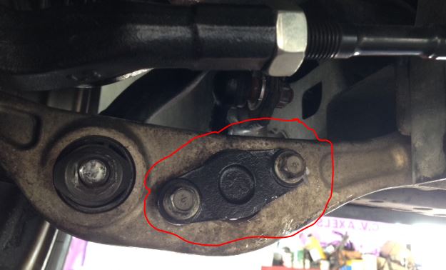

I have a 2005 g35x and need to replace this part (circled red) in the picture.
Do you know if I can buy this separately, preferably from a aftermarket manufacturer?
also if you can share the diagram that this part is called out on, that would be great!!!
note: this part is a ball joint that clamps to the sway bar end link on the other side.
any help is greatly appreciated!

http://orderinfinitiparts.com/parts/...iagram=3840560
It's called a stabilizer link connecting rod. Part Number: 54618AQ305. I don't know if there is an aftermarket replacement. Hope this helps. Good luck!

Hey one more question, do u know if a new lower control arm comes with this part or you buy this part separately?

I don't think so. I'm pretty sure it's sold separately from the stealerships.

That's what I thought too cuz the lower control arm diagram doesn't show that part. Any idea if they have an aftermarket part so that I don't have to deal with stealerships?

MUSHU: a big thanks to you for your help! I ordered the part, got it installed and lone behold my long term front end clunk over uneven road surfaces is GONE!!!
