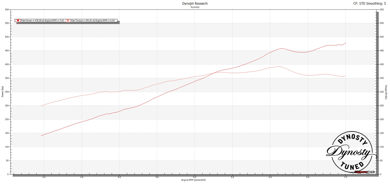

ph do i have one hell of an update, i found out my motor was bored wrong . took it to dynosty at the expense of the shop who was trying to build it. long story shrot dynosty found the bore on the motor was 3x what it should have been and the motor ate itself. that sound i thought was valves was the piston slapping around. long story short cars at dynosty for a full motor build, upgrades to car . we should be seeeing 550whp whn its done . that should be less then a month. stay tuned!

well in process of new motor build we came across so many other things wrong i ran out of money to do fuel and crank pulley and a few other key mods. i only added a intercooler and built Engine.Car made 480 whp and 392 torqe. dyno had what i thought was belt slip around 6k but turned out to be not enough fuel and or need of engine managment. Im going to drive it for a while then it will be up for sale after this summer.

here is dyno
