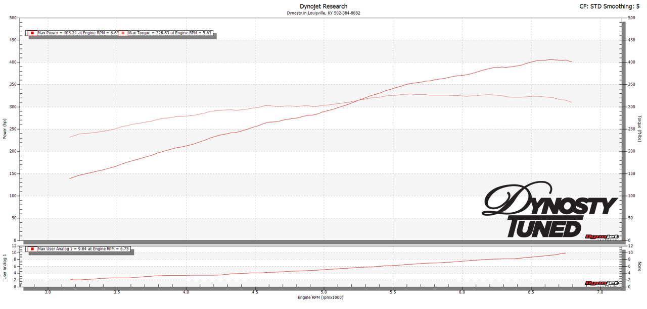

here is chart

Originally Posted by philthethrilloh
correction found out today its a dyno jet
Dynojets always give the highest numbers, they are inflation machines. But again, numbers dont really matter much as long as your A/F curve is correct.

No I meant dynojet. No one ever discusses dynopacks, because chassis dynos are rarely ever used. Roll on dynos are pretty much all you ever see in the states.
Dynojets notoriously gives the highest numbers. Mustang typically read 7-8% lower and dyno dynamics typically read 10-12% lower and are referred to as heart breakers. Dynojets own marketing in the mid-90's specifically used the larger output numbers as a selling item. Shops want to give customers the highest numbers possible, so many bought dynojet and it kinda became the standard.
About 4-5 years ago a guy with a modified 325i ran a test and had his car dynoed on 4 different types of dynos all on the same day.
The SAME CAR on the DIFFERENT DYNOS. So our test vehicle output on the various dynos are as follows:
Dyno Dynamics 200hp
Superflow 206hp
Mustang 214hp
Dynojet 226hp
