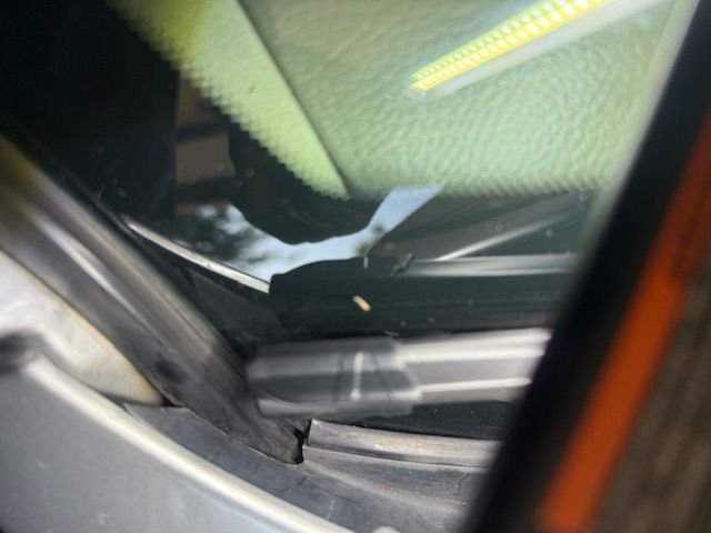

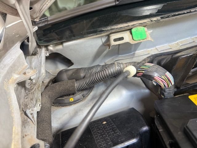

TO FIX : Unplugged and took out the battery and let the compartment it was in DRY OUT. Yep, it was the water getting into the wiring. The seal around the windshield and the plastic pieces near the battery had gaps due to age that water was soaking into the main harness as shown in the pics below. I placed 40 mil poly lining on top of the harness, and kept in place by making holes on the liner that aligned with existing push tabs of plastic cowl/battery cover..
Wiring close to the fender and wrapped in foam was soaked
Corner of windshield and plastic cowl, near the hood has a gap that leads directly into the wiring in Pic1.
Corner of windshield and plastic cow - with end of the wiper and near the hood has a gap that leads directly into the wiring in Pic1.
