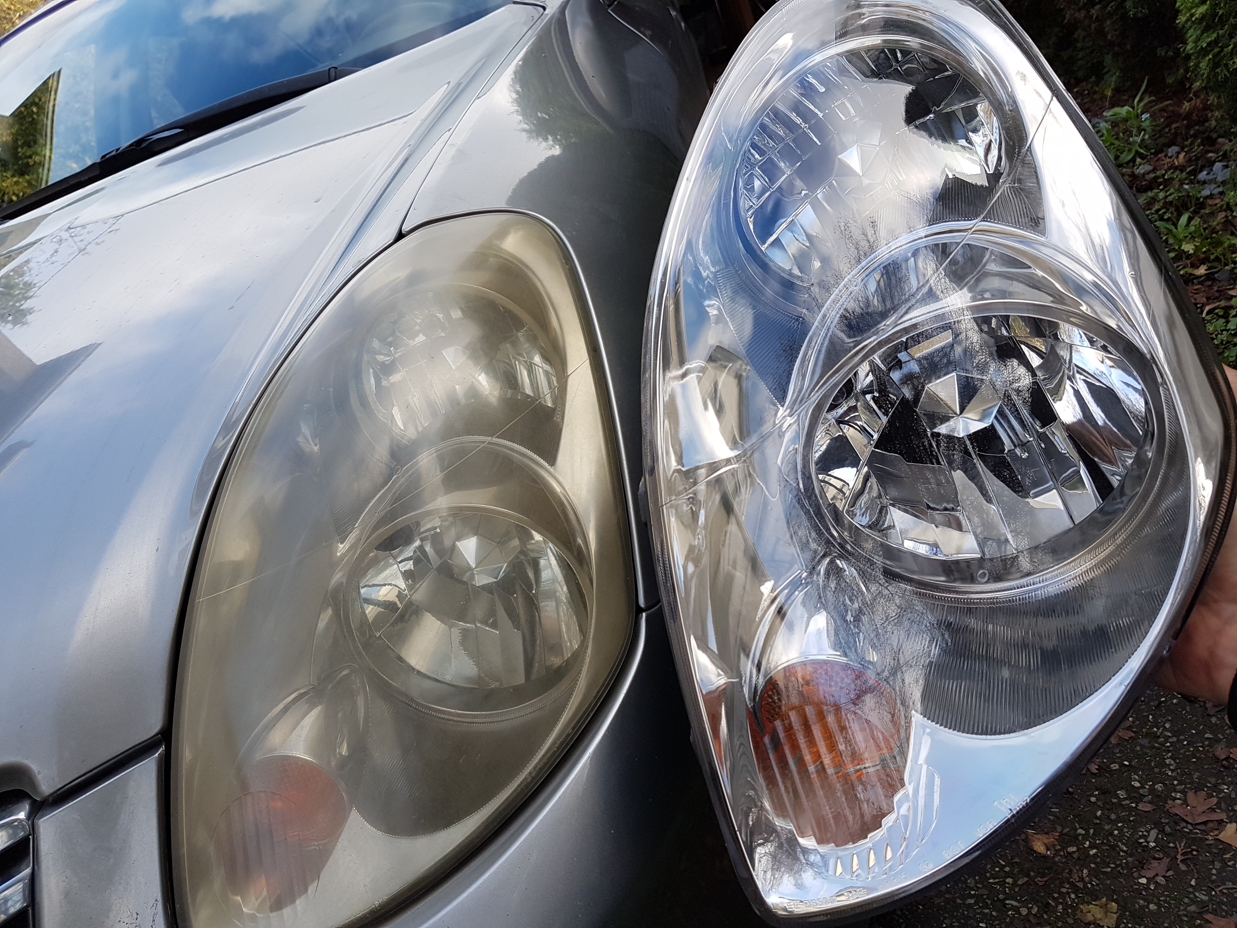

Landed myself a *free* Injen CAI so even though it wasn't on my mods list I just put it on.
I doubt it'll offer any improvement over the stock box but it looks kind of cool and I'm happy to get rid of the big box and associated clutter. Now I can inspect the belts, etc, without having to remove stuff.
Also replaced my driver's interior door panel, because the perforated leather was separating. Found a good used one.
I also at the same time found a set of really nice used OEM headlights (not for free though). Going to wait until the spring to swap the old yellow ones out. My car is HID and these ones are base model, so I think I have to do some slight mods to adapt them for the HID bulbs.
I have "restored" the stock lenses a couple of times, but after a few months they go back to dull and yellow. Probably the worst thing about my car.
Stoked to do this. Look how much nicer they are!

Go with sylvania... mine looked like that pic and look brand new now

Did the same thing with refinishing them over and over again. Just said eff it and bought new lights and opened them up and put some projectors in them lol
I had a quick look inside the "new" ones and from what I remember about changing my HID bulbs a couple of years ago there isn't too much involved with swapping them out. The bases should interchange pretty easily with the reflector housings.

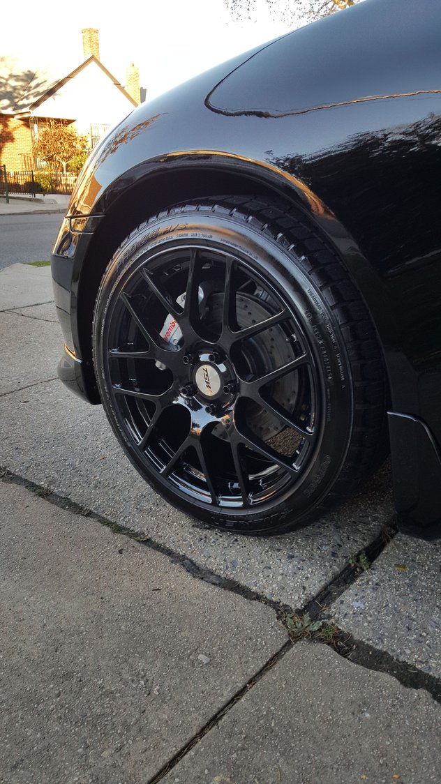

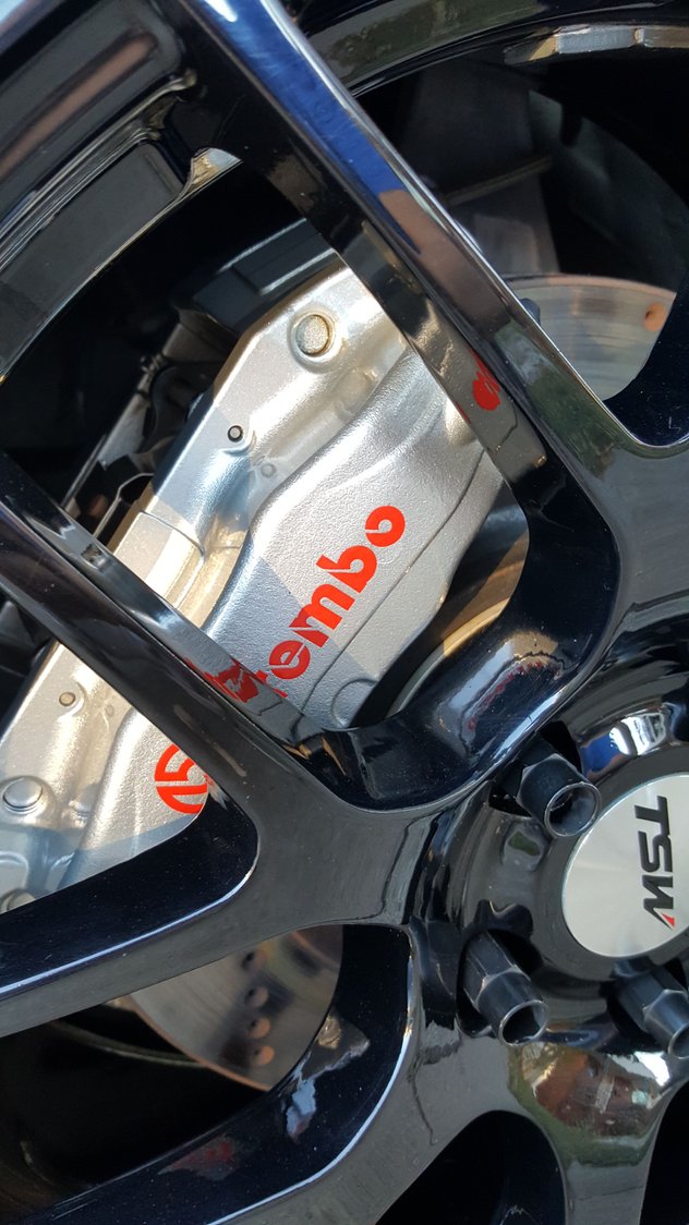

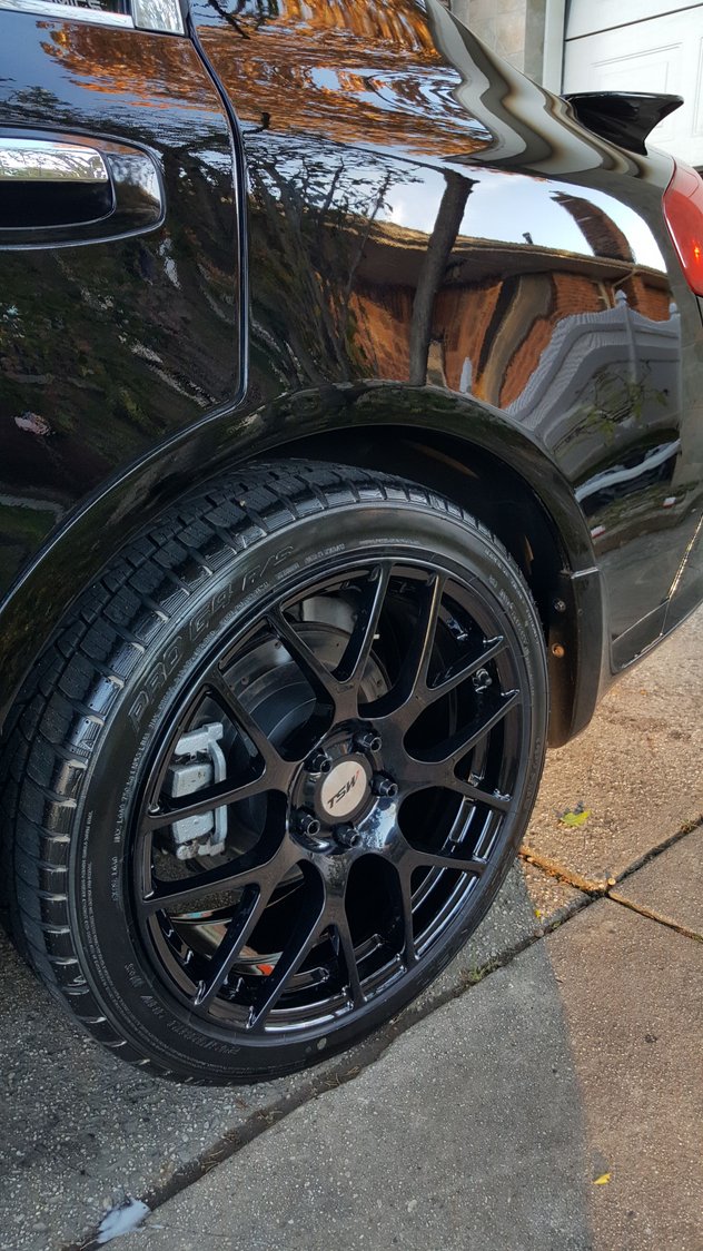

Washed and waxed the inside and outside of my wheels and calipers:

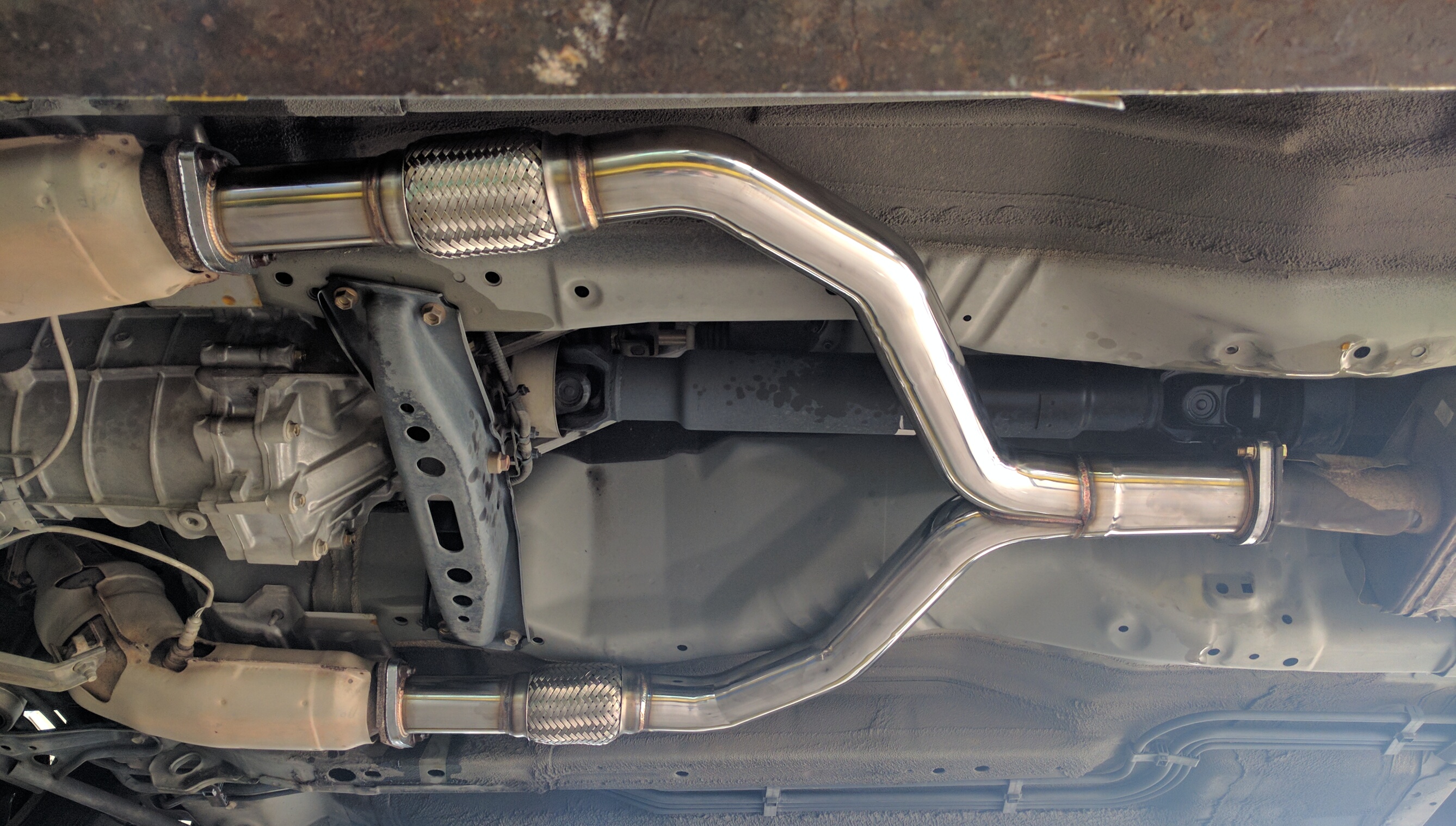

Picked up a Beluga Racing Y-pipe locally yesterday, paid a muffler shop $30! to put it in today. For only $30, no reason to get under my car myself. Nominally louder, seems to have a bit more tone at lower end when accelerating. Not expecting any big gains or anything like that, just another piece in the puzzle.
That's a whale of deal!

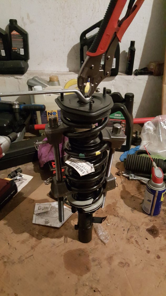

By the way I'm in the process of rebuilding the entire suspension on this car. Instead of guessing where all the noises are at, I'm just replacing everything.
So far I have done all of this myself:
Front and Rear Shocks with new mounts and springs
Compression Rod Arms (Not just the bushing itself)
Lower Control Arm Bushings
Upper Control Arms
Here is one of my new front shock assemblies I built. If you're replacing the front shocks I recommend getting new oem mounts and insulators. I went to the dealer only to find out Infiniti has revised the front upper shock mounts. Much better single piece design:
Still need to do the lower balljoints and endlinks.

Upper control arms are extremely easy. The front shocks have to be removed to access both bolts on the inner part of the upper control arm. after you remove those two bolts and the bolt to the balljoint on the upper control arm, it just comes right out.
Here is the part numbers for the Front Left and Right Spring Insulators and mounts:
Front Left Spring Insulator:
http://www.infinitipartsusa.com/2006...546-124060.htm
Front Right Spring Insulator:
http://www.infinitipartsusa.com/2006...546-124065.htm
Front Left Upper Shock Mount:
http://www.infinitipartsusa.com/2006...546-124048.htm
Front Right Upper Shock Mount:
http://www.infinitipartsusa.com/2006...546-124061.htm
Those front upper shock mounts are kind of pricey at $58 a side, but they have been revised and I could see them wearing out anyways as they are packed with a bushing and metal bearings inside. If you're going to spend the time to change the whole shock and insulator, might as well do everything. I just happen to do the springs because I put coupe springs on my sedan to lower it a bit. By the way those links I provided are for the 04-06 G35x sedan. So you should be good for your 05!
By the way did you run into trouble with space to fit your balljoint press on the knuckle to press the lower balljoint out? I notice the axle is in the way cause it sits sort of above the lower balljoint. How did you get your press to fit into that tight space?
