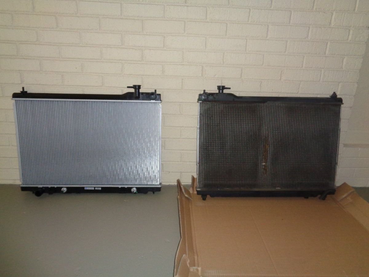

3rd one with overheating problems? Is it the cars or is it you? I would;
inspect all hoses, maybe just go ahead and replace them all including heater hoses
drain the coolant
replace the thermostat
replace the radiator
do multiple coolant flushes with distilled water (see FSM)
fill using a lisle funnel and 50/50 or 70/30 distilled water to Nissan coolant
I got a lot on the subject, much of it on my thread towards the bottom https://www.infinitiscene.com/thread....230572/page-2
I had an ultra-minor leak at the neck of the radiator I could smell for a year yet it didn't show itself until after ordering the new radiator. What's the chance of that

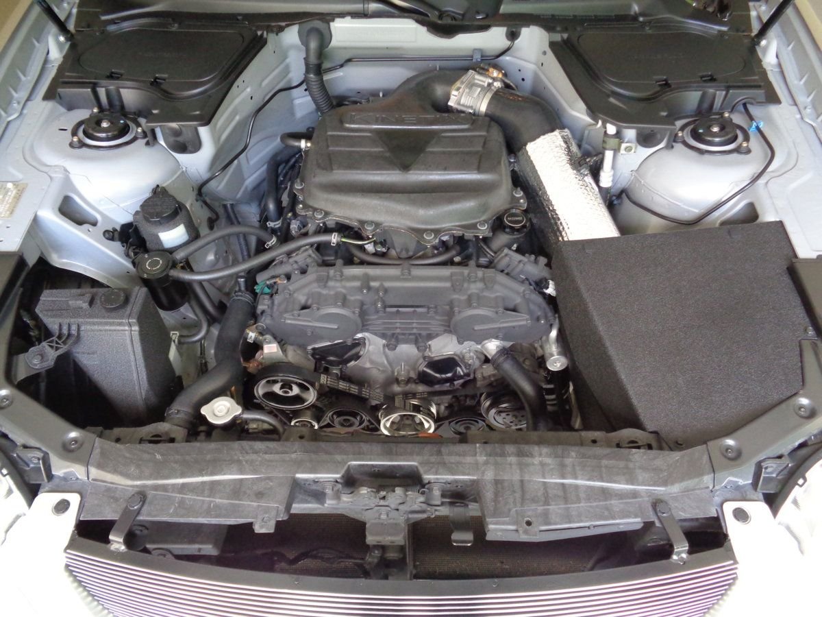

Now would be a good time to delete the mess of heater hoses including the oil filter heater unless you're in a cold climate. This will clean the bay up a lot.

Badass engine bay - off topic, but what did you use to paint the coolant and power steering tanks with? Mine are looking real gross and could use a touchup, and maybe some assistance in holding together in the long term.
Old Sep 1, 2018 | 08:41 PM
onevq35de's Avatar
Joined: May 2017
Posts: 375
Likes: 46
From: Southeast
Thanks. I used wrinkle paint which conveniently matched in both color and texture the abs plastic the air filter box is made out of.
I degreased the reservoir(s) then sanded them until there was no shine on the surface w/300 grit(?). The paint takes 48 hours to dry before handling iirc. You cannot throw these parts in the oven to bake the paint because they're plastic but I found that proper prep and 48 hours before handling is good enough. Over time the engine will bake the paint, perhaps not in the same way but bake nonetheless. My reservoirs are very durable and look just as good as they did when I painted them a year ago.
The manufacturer said this paint is designed to be used on metal but what do they know?

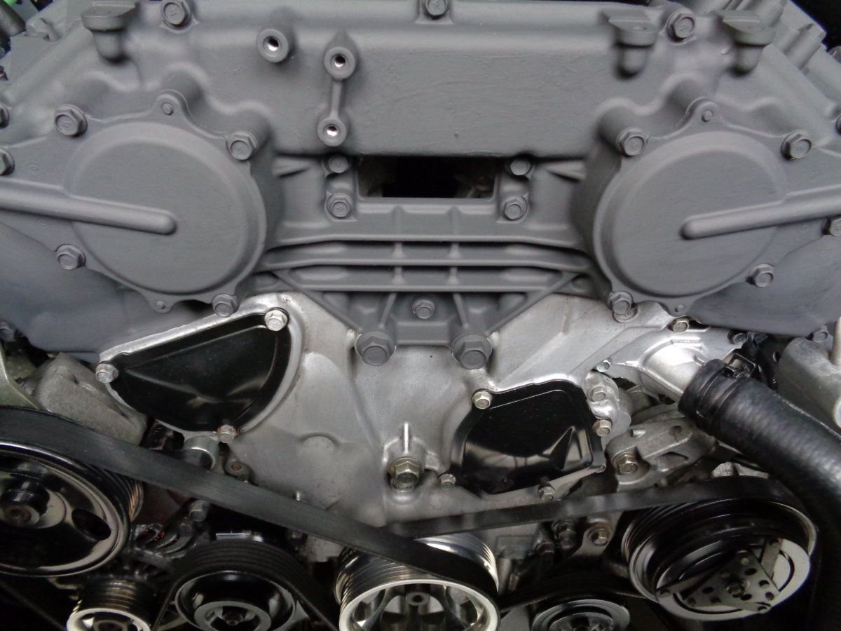

The early 03 models had a mechanical clutch. Thats why there are two idler pulleys on the alternator/power steering pump belt. Nissan removed it in 07 and put a spacer where the bracket was
Old Sep 3, 2018 | 09:06 PM
onevq35de's Avatar
Joined: May 2017
Posts: 375
Likes: 46
From: Southeast
Yes they did and so did I. Weird how it was only the G. WTF.
