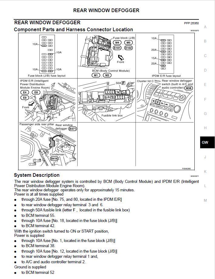

3) My rear window defrost does not work - button does not light up, all others are fine. From another post, I've checked the the fuses and the 3 big relays (swapped them around) in the area behind the battery. Not sure where i can access the pins that connect to the defrost grid to check for current, is it behind the rear pillar?

3. See attached snipped about rear window defroster.

I went out and checked the fuses again based on the diagram, and all visually looked fine. I'm hoping its not the hvac unit, but everything else on it works - although i did notice the amp to the speakers have cut out randomly today...
From the diagram I think the hvac button is what allows the ground, and from there the circuit is complete and sent the rear window (grounded at the frame). So if I metered the defogger unit at the back i wouldn't get any power.
I think the diagram shows the middle large relay is the used in the defrost system - which i swapped with no luck.

Hold your finger on the relay while someone else operates the button, you should feel it CLICK as the relay snaps shut. If you do feel something then it's probably a wiring issue going back to the defroster element, if you don't feel it click then either the relay is bad (definitely a component that wears out) or it's not getting power through some other part of the control circuit.
That's a good idea. I did swap the relay with another in the same row - no luck.
I feel like i need to meter the HVAC controls and confirm power is coming in at that pin for the defogger button.

Also still fighting with the rear defogger.
When my father got this car it came with an aftermarket deck - i replaced it with a bose SAT version. Neither the metra or this head unit worked the rear defogger.
From the diagrams provided below, i confirmed power from all the points in the fuse box, but not at the head unit.
Removed the rear cover for the defogger relay at the rear windshield, no power back there. I removed the relay and cleaned up the ground contact - had a good amount of corrosion, still no luck.
I'm no longer clear on what the issue could be, maybe i should replace that rear relay/control unit (labelled condenser)?...i'm really hoping its not the head unit, since the old metra did the same thing.
There's only a single wire coming into the rear relay, so i'm assuming once the button is pushed from the head unit, the power is sent and once grounded there, the head unit light would come on - this is an assumption however.

Update on my defogger issue:
Rechecked the 2 main 20A fuses and the relay (under hood behind battery), no luck, confirmed power at the required points in the fuse box as per FSM (interior drivers side)
Took the drivers side plastic off the rear window to look for any loose or rusted grounds, and all looked good.
I think my only next step is to check the wire harness at the control unit (hvac/audio), maybe the defogger line was damaged from the previous owner...
Any thoughts from anyone else? "Winter's coming" and i need this working
