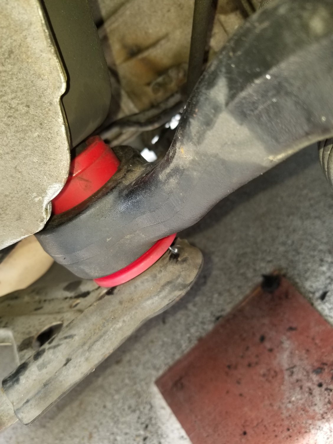

So I just noticed some clunking going on from the passenger side front, decided to take a look and saw that the compression rod bushing was completely sheared. I know these go bad, but I think it shredded itself during a visit to goodyear for an alignment. They claimed I had a bent tie rod, and I told them I'll fix it myself, and when pulling out of where they parked it, the car was undriveable, with the wheels so cockeyed I couldn't even steer the car. They said they never touched anything. I argued with them that I drove it for two weeks with no issues and it was fine before they put it on the lift, and now that it's off the lift, it's undriveable. I saw the pic they sent me of the mildly bent tie rod. When they put it back on the lift, which was difficult because steering was so screwed up, I took a look and the tie rod was literally shaped like an S. I think that's when it completely sheared the bushing and the post is even bent. I couldn't get the spacer of the old bushing off even though I can get it to spin. I just threw a poly bushing from a 4 link kit for my 4runner in there so I can keep it driveable and not metal on metal clanking until my Armstrong ones come in. When I finally got all the rubber off (left the spacer on the post) and got everything in, I sat there for a second just staring, and happened to see an empty hub staring back at me. Then looked at the empty wheel hub. Then back at the transfercase. Then it finally hit me there is no cv axle there. I looked at the driver side and there isn't one there either.
I haven't gone back under the car again yet after getting the wheel back on because I'm kind of tired of messing with it right now. So I haven't looked at the condition of the diff and if the front driveshaft is there. But I did some searching and all I could come up with doing a RWD conversion is pulling a fuse under the driver seat. I guess I don't necessarily need to go back to AWD, and just wondering if any unforseen problems may happen by leaving the front axles out.
here's my ghetto rigged temporary bushing. There is about an 1/8" play around the center sleeve, but better than 1/2" play of metal to metal.

Bright red looks good in there. Nice work. Good luck with the rest.
