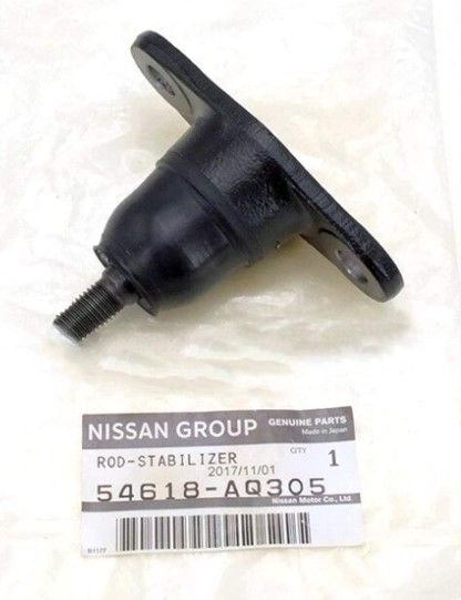

I'm guessing you're working on an AWD model G35 since the RWD ones don't have that stud. You need to replace that whole stud piece it bolts to the transverse link. This should be the correct part.

I'm very familliar with thread-serts. We use them at work frequently. I just think there's far too much tension on a sway bar for it to work even under normal driving, first time you hit a steep parking lot speedbump or entrance at an angle you're putting almost 1500 lbs on the thread if you roll over it at granny speed. If you were really in a pinch you could cut off the existing one and drill/tap the housing to accept a piece of grade 8 allthread maybe??
The OEM replacement piece is a 15 minute job to fix and only costs $60 so I would definitely recommend that route.
Here's what the component looks like, it's very different than the RWD setup.

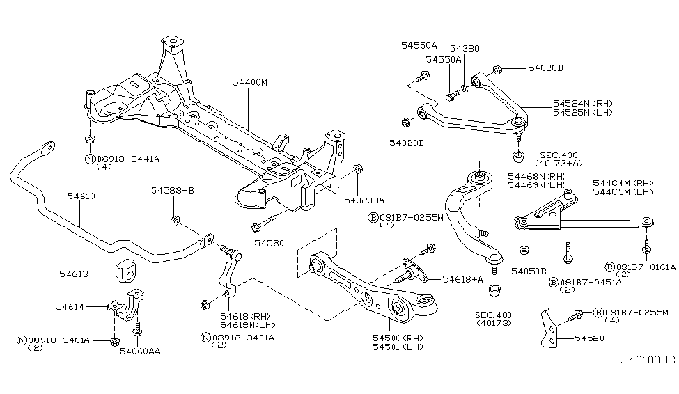

Actually, its not this part. Thats for the endlink. The part i'm talking about is on the subframe itself. Bottom left corner of the image. As you can see the #54614 is the sway bar bushing bracket. The front is a nut (08918-3401A) and the rear is a bolt (54060AA). There is a stub on the subframe that the nut threads on to, that is the broken part. I believe the stud on both AWD and RWD subframes.
I'm thinking of drilling it out but i dont know how much material is there if i can tap new threads for a small m6 bolt.
