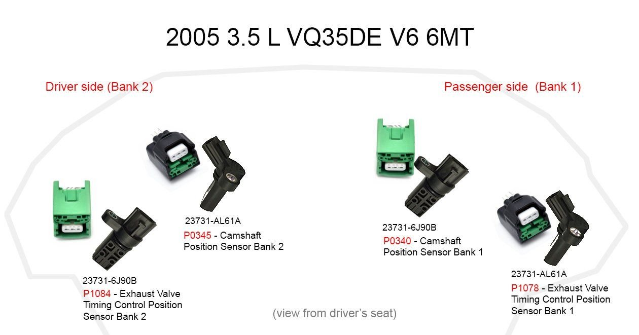

If you didn't use a Hitachi or a Genuine Nissan Parts OEM cam sensor then it's probably still a bad cam sensor. These engines don't play nice AT ALL with any aftermarket sensors.
Exactly what code did it throw?
Also, when trying to start the engine, while it cranks do you see the tach move? If not you could have a crank sensor went out as well. What condition was it in when you had it out for the transmission job? Also make sure that it's bolt is snug, if it backs out a little it won't read the flywheel pickups.
Ignore the exhaust sensor codes, you don't have the rev-up engine, the other stuff is the same though.

[QUOTE=cleric670;7212553]If you didn't use a Hitachi or a Genuine Nissan Parts OEM cam sensor then it's probably still a bad cam sensor. These engines don't play nice AT ALL with any aftermarket sensors.

If the computer is throwing P0340 it's because there is a problem with either the sensor or the wiring or the cam tone ring. The ECM is literally telling you there's a problem with THAT sensor, not a misfire on a specific cylinder which will throw P0300 - P0306.
Now swapping out for fresh plugs isn't a bad idea, especially if they have 50k miles on them or so. But that's not going to make a cam sensor start working again. The ECM is reading the angle (frequency) sent from the sensor and seeing that there is missing or incomplete data being sent.
If the ECM thinks the cam angle is at a specific point but it's sending wrong, missing, or incomplete data then the ECM doesn't know exactly when to control fuel and ignition timing, this will make your engine run terribly.
