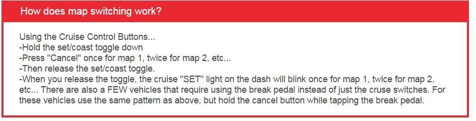

Check for map switching, that will tell you if its been Uprev flashed or not.

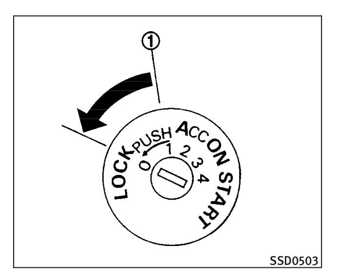

Your '06 has a "push and turn" ignition, right? Have you tried any of the physical keys in that switch (with no fob in the car)? One possible scenario could be that the original owner misplaced both original fobs, including the physical keys. Then bought a replacement fob and changed the door lock cylinder to match that new physical key. But instead of also changing the ignition key cylinder (expensive) they stashed a fob and programmed the car to start from that one... Just a theory.

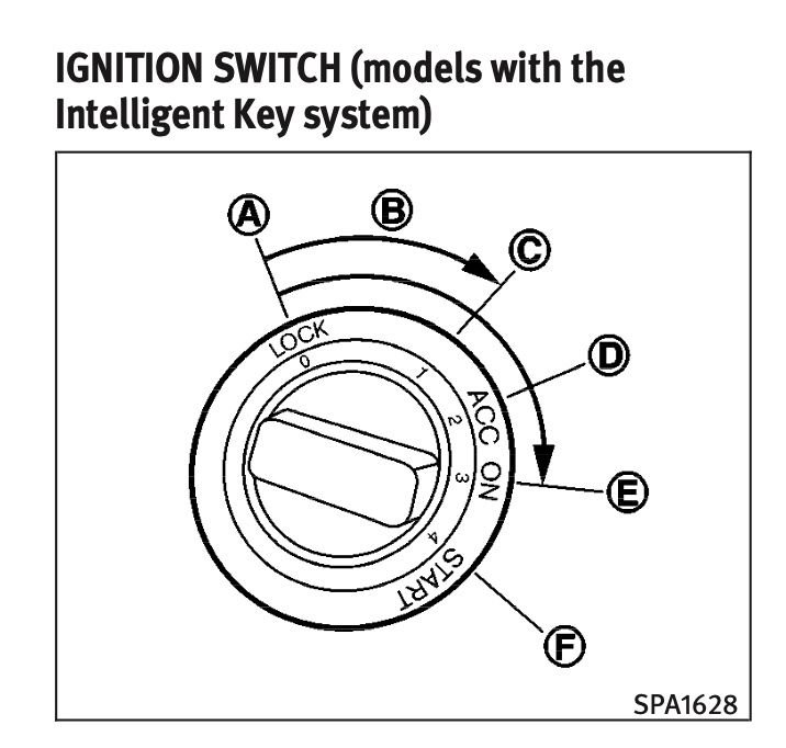

I think what he was asking is if you have the intelligent key system or not.
Do you have to put your key into the key slot to start the car or is there a twist **** on the steering column and you can leave your keys in your pocket.

Um, yeah, er... I read this whole thread as if he's talking about discovering an iKey fob hidden under the passenger seat which was allowing the car to be started with no other key or fob present. I could easily have misunderstood the entire story.
So OP: does your car have the iKey system with a push and twist ignition switch? Or the more standard old-school ignition key slot?
