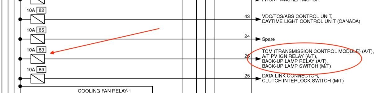

Gonna take a stab at it although I don't really know anything. Found this illustration from a 2005 350Z FSM. Looks like the Reverse switch should be on the driver's side. Before you go tearing it apart, make sure it's not just a fuse or something simple...

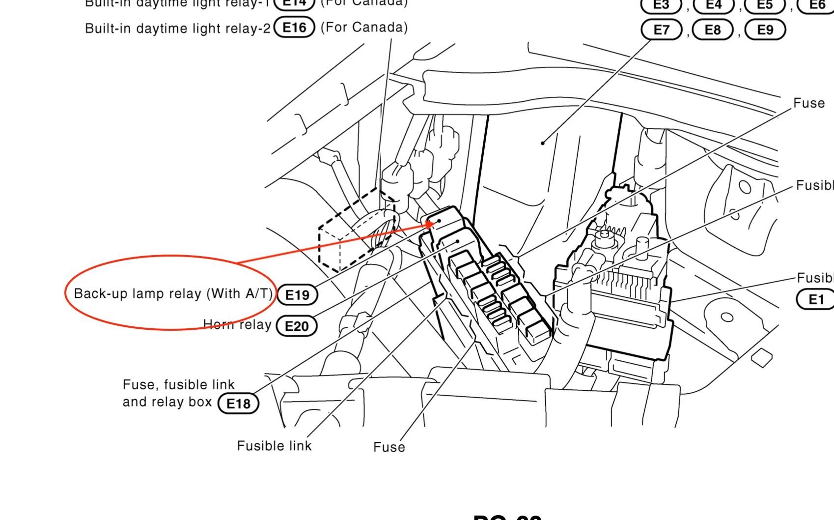

But here's another clue. Fuse # 83 in your IPDM shows an output to "Back-up lamp relay (A/T)" and "Back-up lamp switch (M/T)". If your car started life as an auto then you probably have this relay "E19" mounted in front of the battery? But it looks like the M/T just used the switch directly. We can presume that this relay is already wired to the back-up lamps but you'll need to find a creative way to trigger it from the manual trans switch...

That's what I'm saying yes, but it will take some effort. Dig through the "PG" Power & Ground FSM for your car. It's not an easy read but all the circuits, connectors, wiring harnesses and wire colors are in there. It just takes some serious decoding. If you can figure out how that AT relay is wired, whether it needs ground or +12 to flip and send power to the lights... then you will need to find out if your MT has the switch and see if you can run wires from it to that relay. If the relay only needs a ground then you may only need one wire to run from trans to relay...
