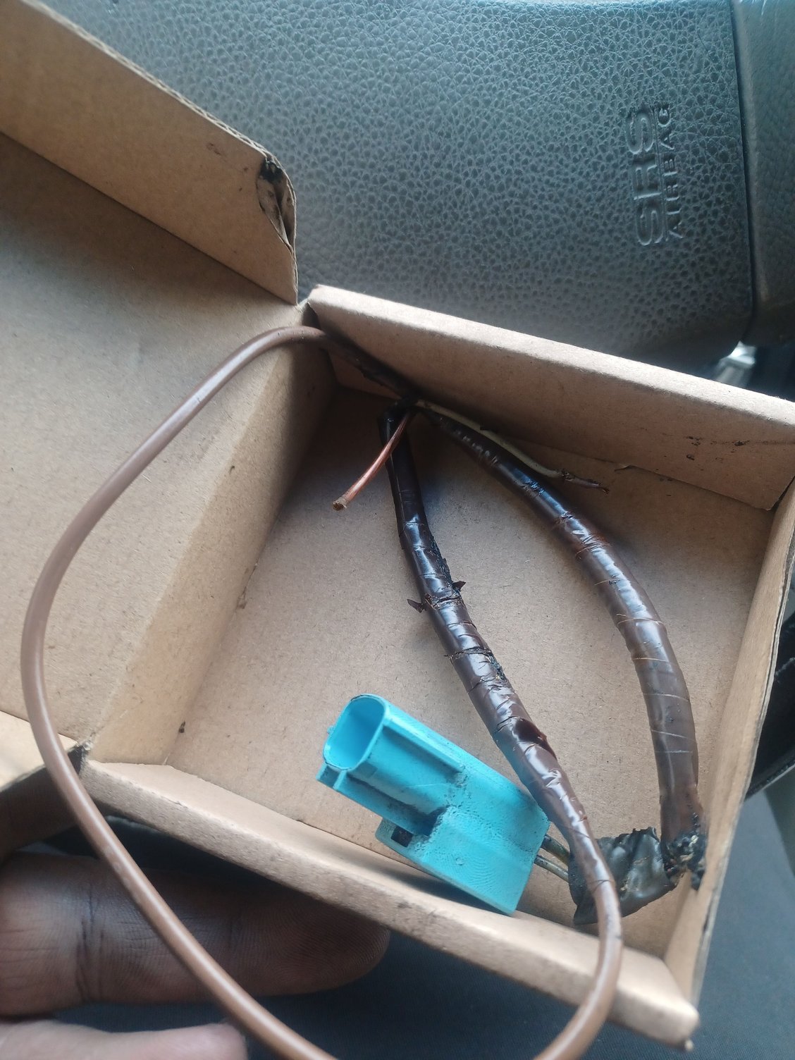

You'll get back your normal timing advance of 45 under throttle once you fix that knock sensor. The engine pulls a TON of timing when it's not reading it. Everything else sounds pretty normal
Old Apr 30, 2023 | 03:44 PM
  #17
Howardb's Avatar
Joined: Aug 2022
Posts: 57
G35 sedan
Thank you guys for all your help I changed out the wire using hangers and makeshift tools come to find out at the sensor side no wires were connected. Feels fast again and took me about 20 min. You guys are great
