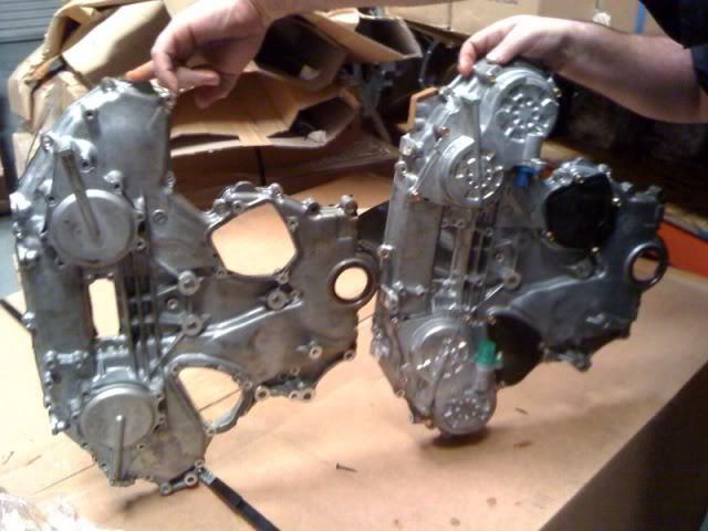

The 6MT newer ones have what's called the "rev-up" VQ35DE engine, that will not work. It's easy to identify though by looking for the "waffle print" on the front of the cam actuators, here is a picture.
The cover on the right is the rev-up, you want the engine that looks like the one on the left which has a smooth cam cover with that single raised line.
