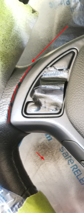

My wife had really one complaint with our G35 for a few years. She has asked me several times, if there was something I could do about the ugly marks on the steering wheel. I recently started to play with Plasti Dip. I went a little crazy on the car first. then I got the bright idea to try to fix the steering wheel with it. It turned out amazing, and looks brand new again. best of all, it only cost 6 bucks to repair.
this is while I was in between coats
Final result after 5 coats to ensure quality

Use the plasti dip black.$5 to $6 bucks. I found mine at lowes. also get you some tape and drape its about $7 bucks (this stuff is amazing to help mask off the over spray ) I used a citrus base cleaning rag that had some nice texture to it, this helped me remove all the original neoprene right down to the smooth gray surface. clean it up really good with some good window cleaner, and make sure its very dry. if you check out some of the videos on dipyoucar.com what the video on how to dip your vehicle emblems. this will show you how awesome plexi dip really is, and show you just how easy this will be do do your steering wheel. I did 5 coats to ensure quality and make it easy for me to peel off the dip from the area's i did not want it sticking. you don't really need to trim off any of the steering wheel except the out edge from where you are. the only important part here is tape off well, they when you spray the last coat, take the tape off while it is still wet and you will get a nice clean line. this was the only area that did not pull right off for me. I added a little tape on each selector **** to keep the dip from getting down in the cracks where I thought i might have a hard time pulling it out. overall this turned out very well, just like factory or possibly better. it feels just like the factory coat and so far has not damaged. If you need any help, hit me any time.
