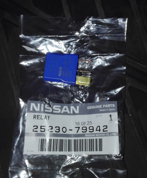

The relay is BEHIND the the panel of fuses where your pedals are..you have to take off the panel that's next to your left foot when sitting in car. And it exposes the panel and two screw on top part of it..unscrew these and panel should slide off rail guide and the two relays are on the back looks like a blue box with prongs
Some pictures for g35 2007/8 +
open fuse area
unscrew this, remove plastic covering
un-clip white fuse block. Unscrew this nut so you can turn teh fuse block around enough to pull out the top relay (no clips, just gently and consistently pull relay)
This top one
replace with 25230-79942
