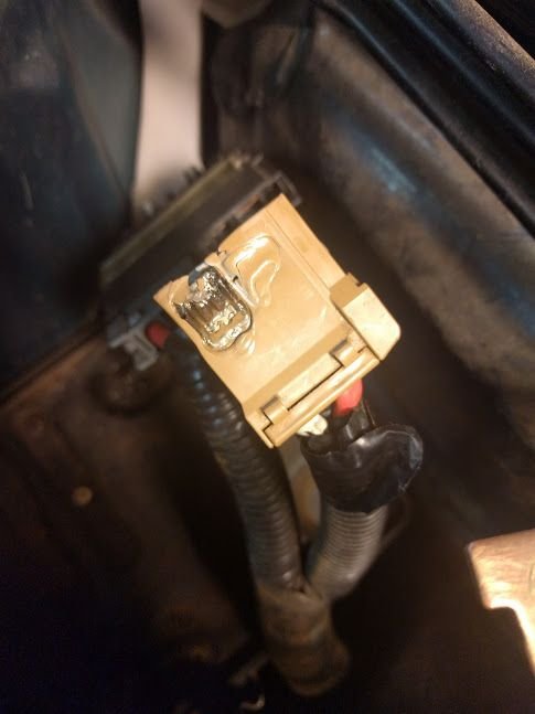

Anyone know what this is called? or the part number? (The brown and grey plugs + wire) It plugs into the fusible link at by the positive battery terminal. It's on a 2007 g35x. It looks mine is melted a little, and I unplugged it and it won't plug back in. Looking for a new plug and the wire that is attached to it.

Yes that is your fusible link and yes the harness is melted. Unfortunately the wiring harness is literally one piece for the entire engine compartment, every sensor, everything. You should check wrecking yards in your area for a compatible match and cut the harness from it and splice into your harness. Take it to a reputable stereo shop in your area if you aren't familiar with how to make a soldered connection and shrink tube.
The fusible link itself is easy and you can buy a replacement from any parts house, it's ok to go Non-OEM for that part.
This was very helpful info. The wiring harness is easy to find on ebay, however, in most cases, the plugs aren't included. I finally found one with the plugs included, and had someone come over and splice it together for me for $75.

Win! Glad you got that all squared away.
