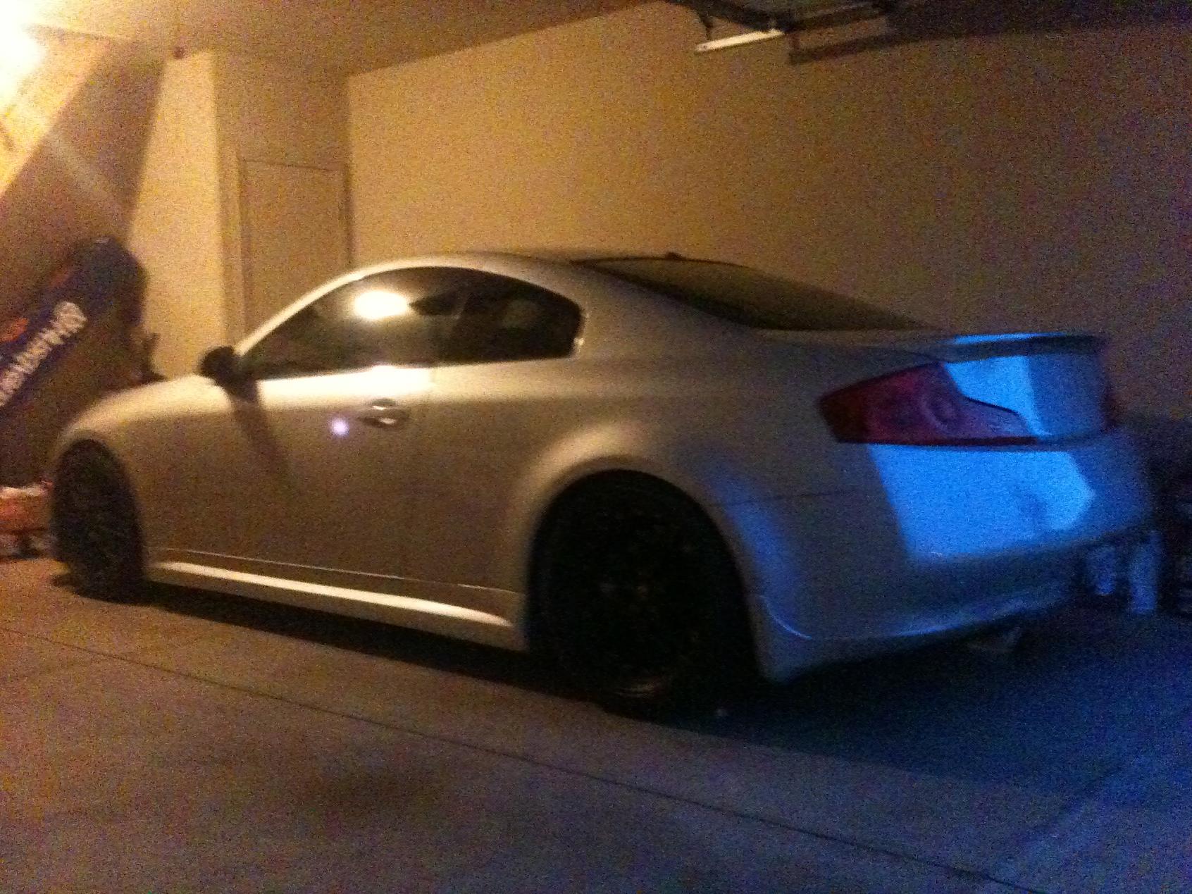

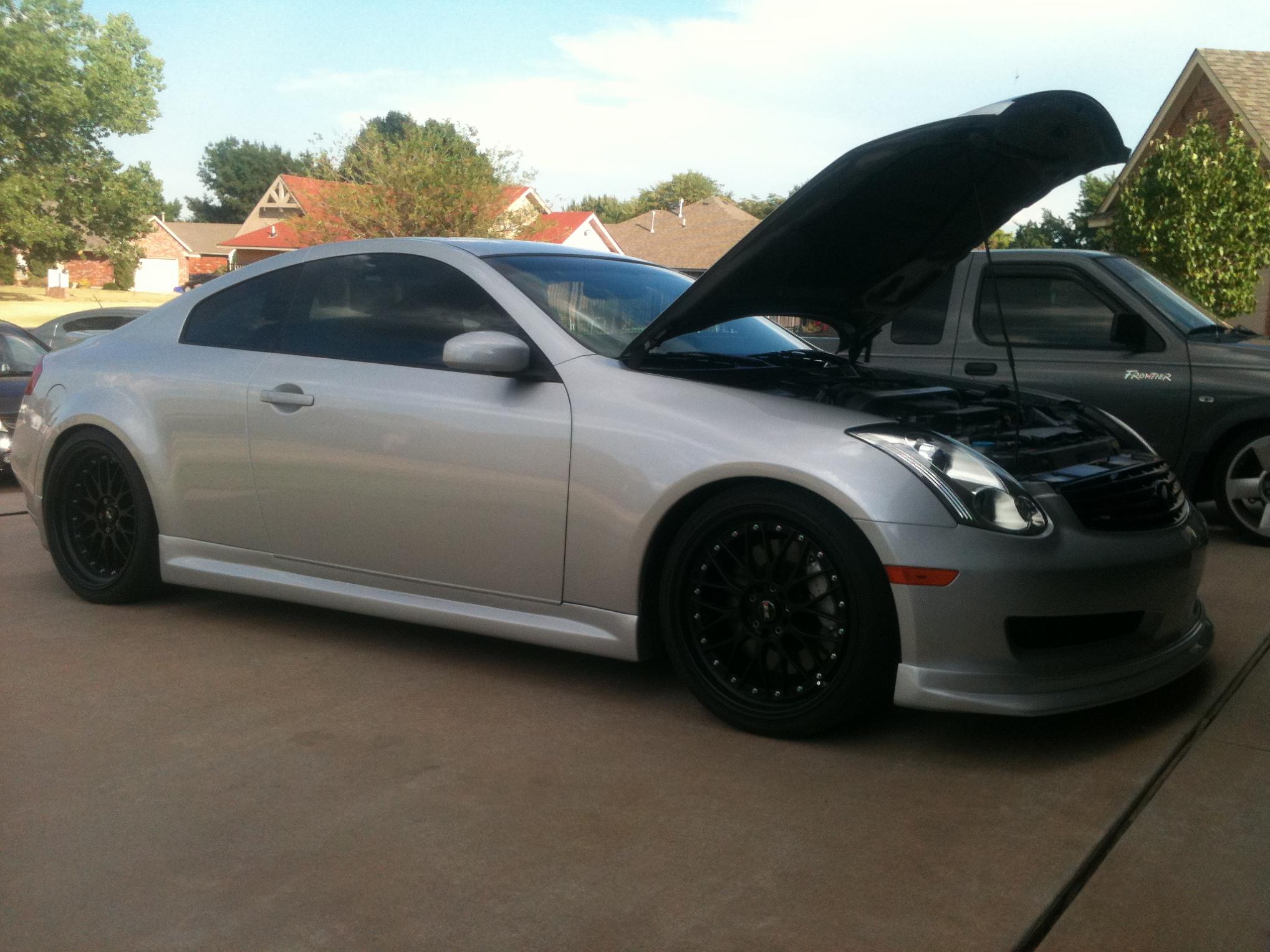

I opted for the prokits and couldn't be happier, although I think it may have lowered it a little more than the advertised drop. Either way, it looks, handles and rides great. Tire wear is livable for me.
I also have Eibach sways with whiteline end-links, Attached are pics for reference.
