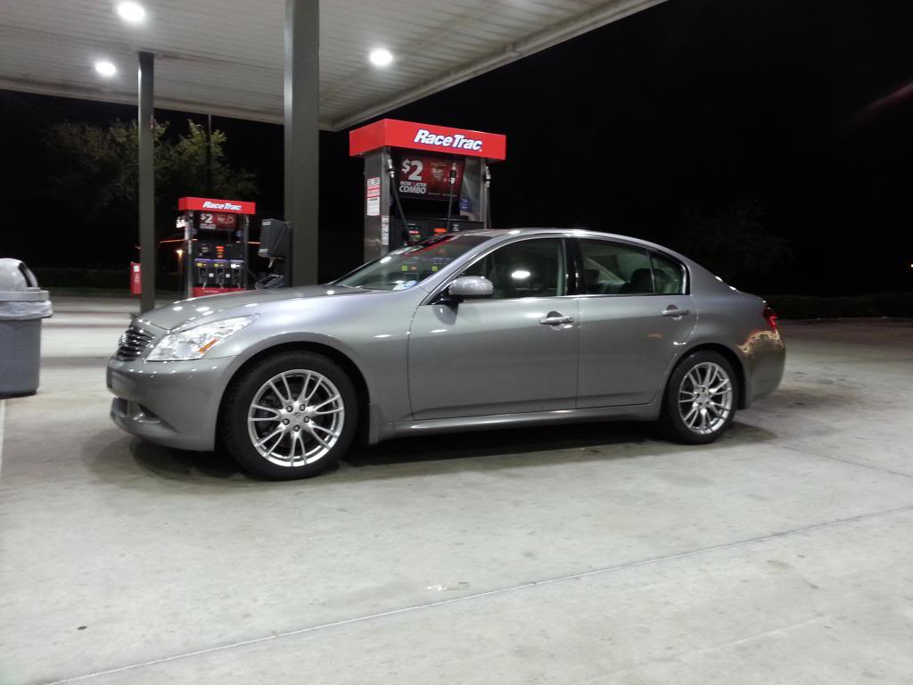

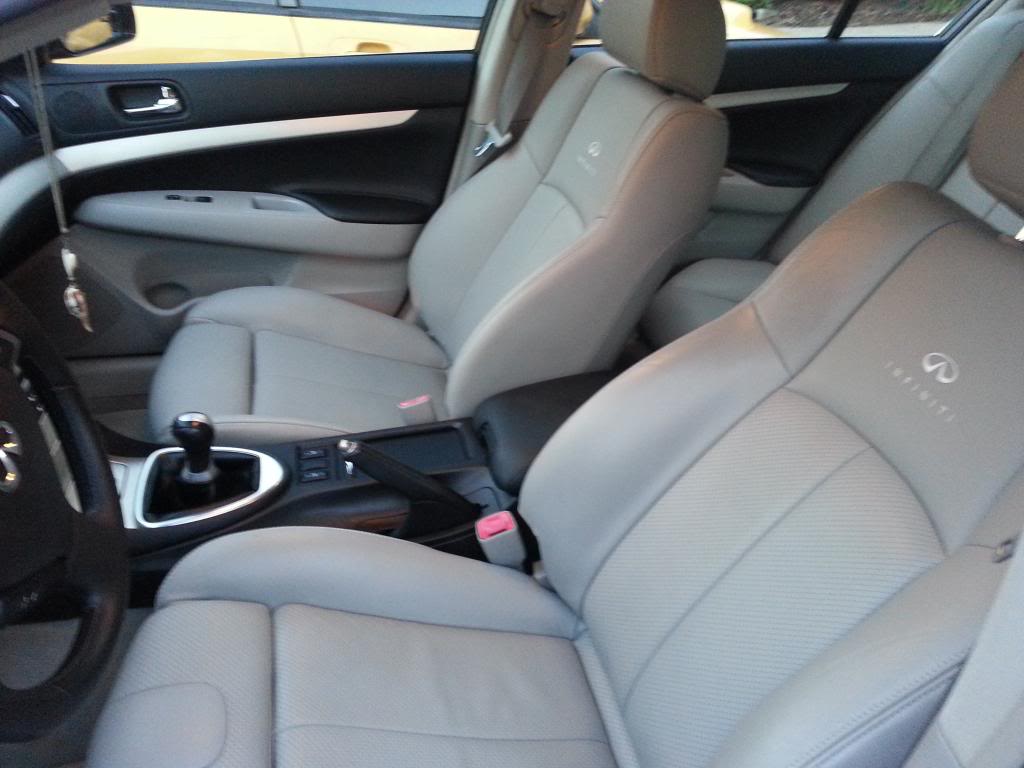

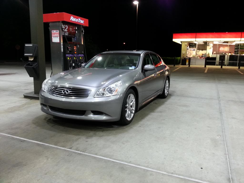

Hey guys. New to the family here. First time owning an Infiniti and I must say I love her so far. Coming from a boosted sc300 I must say it's obviously not a rocket but it's no slouch either. Love the ride and the handling. Picked her up 4 months ago. Had an 08 auto for about a week before I bought this one but had to return to the dealer(long story). Picked this up for $16.900 with 61k. One owner. The interior is clean...the paint is good except for some spots on the hood and front bumper where Florida love bugs have eaten into the top coat. Not sure how the owner let that happen .

Looks beautiful!

Looks clean and shiny for an 07. And w/ low miles

Gorgeous car. Looks like it is in great condition.

Thanks for the compliments. Yeah she's beautiful. Got lucky with the mileage.
