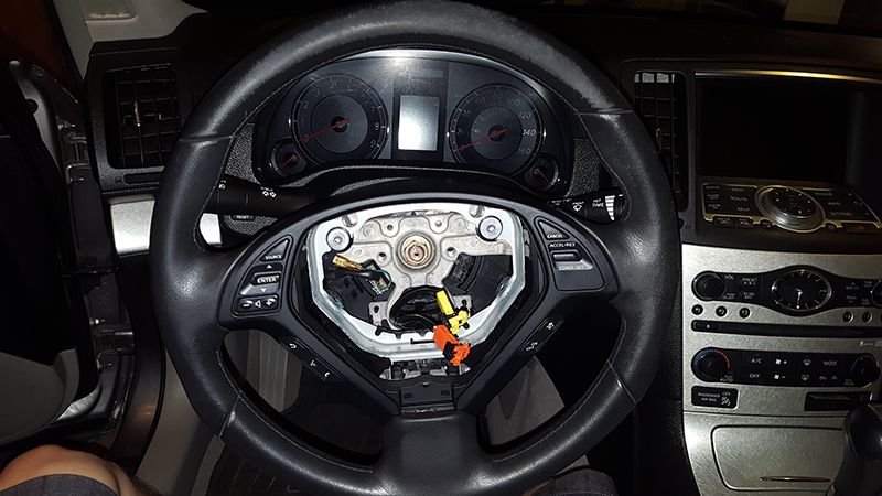

You can see here what my old wheel looks like. It sucked, it was annoying to grip, and looked terrible. The top of the wheel felt gritty and I often noticed my hand would have small black particles on it after a long drive. The rest of my car is super clean, but the steering wheel looked like it was from an old sunbeaten car.

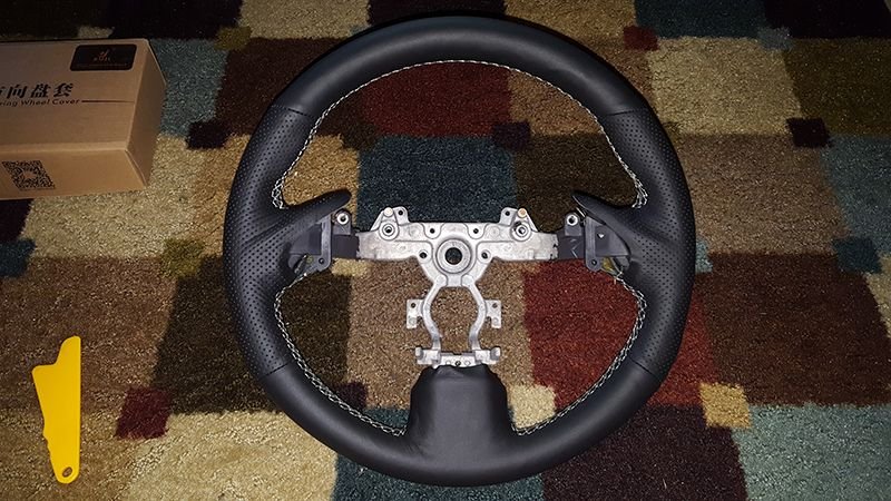

Once the wheel was off the car, the first step was to put the double sided tape on the outer edges of the wrap. Some wraps do not use tape, this one did. I was on the fence about it, however in the end I am glad I used it. Lemme tell ya tho, it sucked. It took maybe 45 minutes to peel off the double sided tape after this wrap was put on the wheel because it is super tight and sometimes hard to reach. However, the tape did hold it in place and I would rather spend more time with the tape than having the possibility of a slippery cover (which I don't!).
Once the taping was done, I put this on the wheel and got it test fitted as well as I could. There are seams in the wrap that match up with the seams on the wheel itself which made it easier. It will never line up perfect, but I did my best to make it look like it was going to wrap around the wheel and it worked out for me.
After the test fit, I pulled the double sided tape and pressed it firmly into place. Once it felt "right" I began the process of hand sewing the wrap. I dare not explain this, rather, watch that aforementioned video (and others on YouTube) and they will show you how to sew it. This part took me probably 3 hours to do. I did take a few breaks, but in reality I watched "Training Day" in entirety and I wasn't even done sewing by the time the movie was over. My recommendation for this process would be to make sure you follow the video (or written) instructions, and pull tight on the string as this stuff is thick and pulls itself together nicely. When all was said and done, I was THRILLED at how this turned out, even before I reinstalled it on the car.
The last part was the reinstallation which was once again, very easy, since I had done this before. The new wheel looks great, didn't add very much thickness at all which was something I was concerned about beforehand, and it feels awesome to grip! I never poked myself with the needle, and even though the whole process, start to finish, took almost 6 hours, it was well worth it. Ideally I would rather have a new wheel, but at a near 1/9 the price, I would do the wrap again for sure!
I by no means am a pro sewer, actually, I don't know that I have ever sewn more than a small rip in a shirt, but I did a decent job. It looks great on the car, and the picture doesnt do it justice. The last pic there makes the color look like an off black, but it's not. That pic is in the sun with the flash on my phone, all the other pics were inside my house or garage. The black matches up perfectly, the perforations looks great, and it fits very well. Keep in mind that, in my example, the wrap never fits perfectly. There are some spots where there is excess material, so you can feel small wrinkles in it. Someone with more experience could likely do better, and it no way matches up to the smoothness of a brand new leather steering wheel, but again, for $50, you can't beat it! I was never going for perfection, but it sure looks and feel way better than it did before, even with small imperfections in there.
