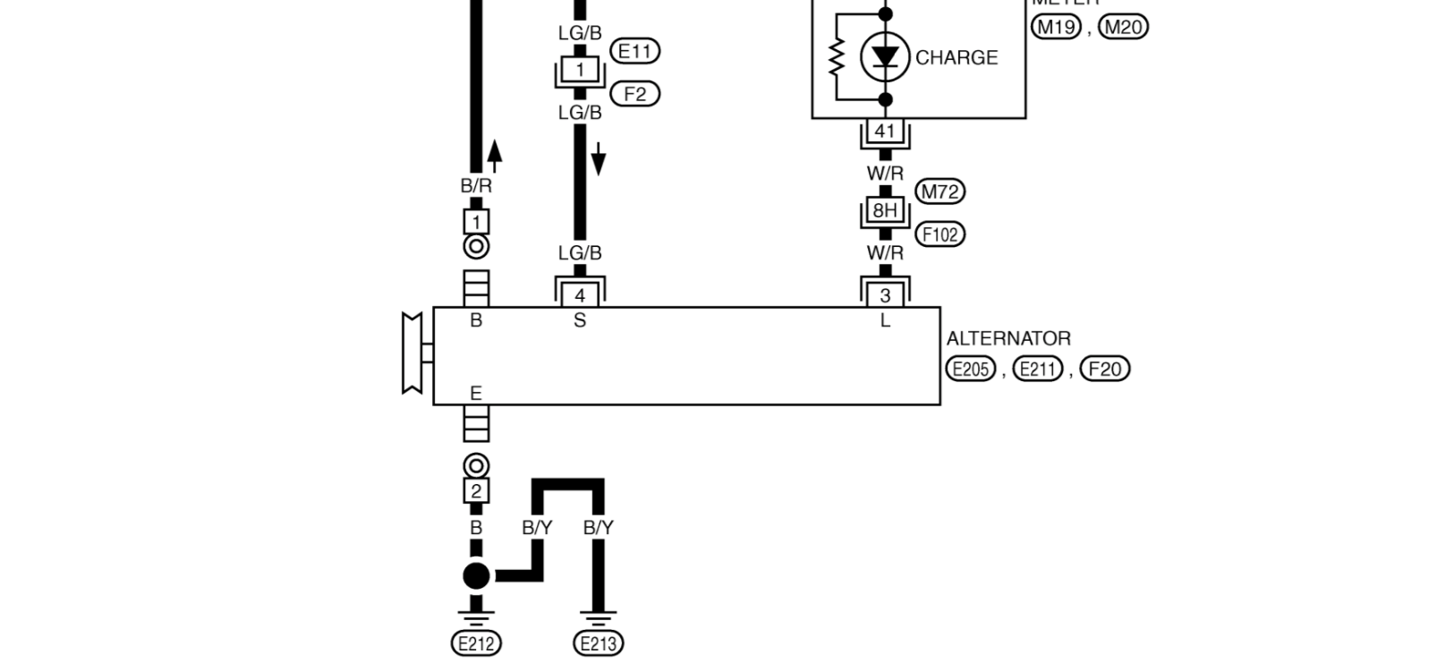

Alternator connector wire colors for a 07 G35
They grey plastic part of the alternator's wiring connector is completely gone. I have a replacement but the wire colors are different, anyone have a picture of the connection's wires so that I can match up which wire goes where? The car is a 2007 G35

Does this help?

B/R = Black/red stripe
W/R - White/red stripe
LG/B - Light green/black stripe
B - black
B/Y - Black/yellow stripe
