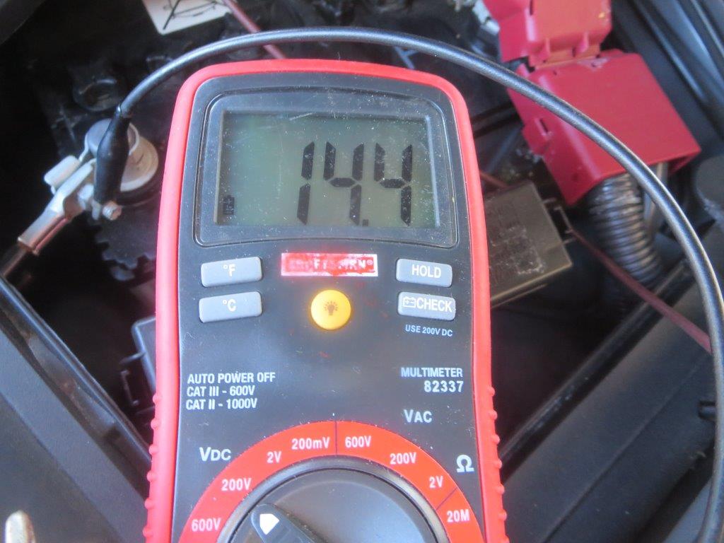

Use your multi meter to measure the output voltage from you alternator when you finally get your vehicle running. Should be 14.4 volts.
