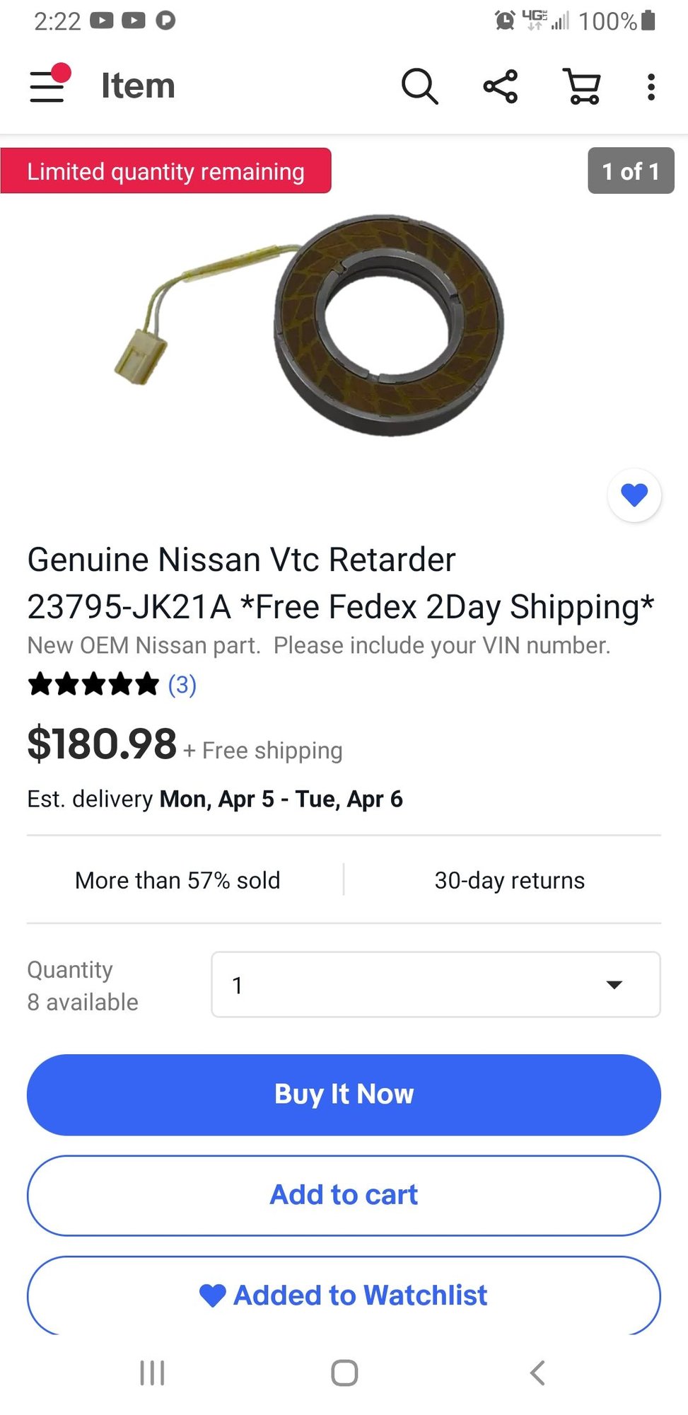

Where did u find the retarder for $180? Every one I've found has been $600 or better new.

$600 that must be for the whole cover. The magnetic retarder is mounted inside the cover. I just replaced the retarder and the three seals. Actually, I bought two but only needed one so I am returning one this week. It cost $168 to my door. I got them off of EBay from a Nissan parts dealer in Longwood, Fla. I bench tested and cleaned the solenoid in the cover and it tested good so I didn’t see a need to replace it. Once I had the cover in hand the Retarder replacement literally took me less than 10 mins. The manual relearn took on the first try. So the repair for P0014 cost me about $210 total in parts.

Yea. That's the whole cover. Haven't seen just the magnetic retarder alone.

Is this it?

Yes, that's it.
