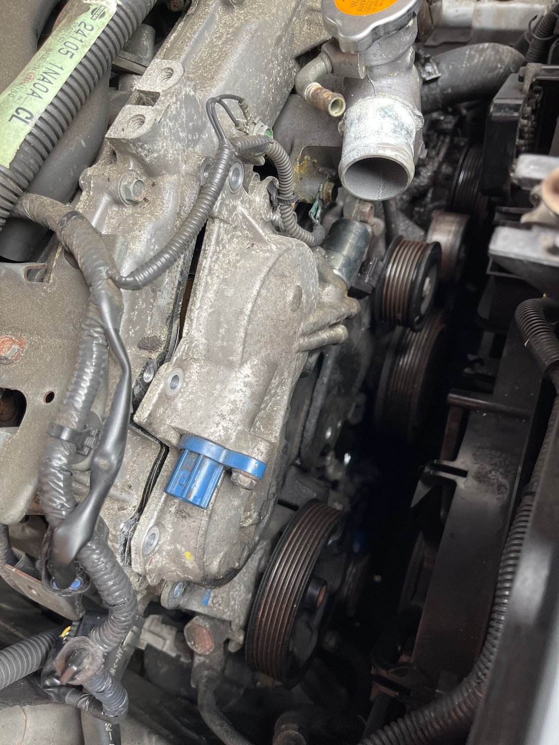

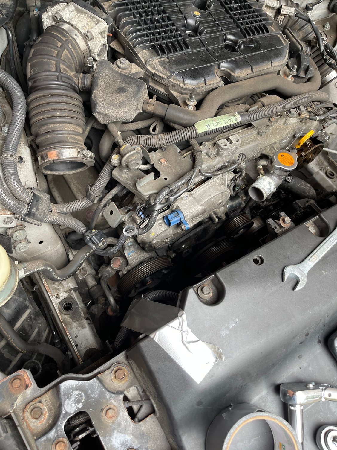

yes proper PITA. I only did the ‘easy’ side so far and boy that was something. But it finally came off.
For the ‘crazy’ side, Ive managed to get the belt tensioner off and it actually looks like that’s where the bolt #8 is(meaning I wouldn’t have to take off the power steering pump… I think)…. but that’s where I
stopped.
and yes I bought them off EBAY for the price you mentioned and I think the name is “coutlerstore”, it saidgenuine parts so I went for it.

Posts: 59
G35X
Good deal....less you have to take off and move around the better. I like how you describe it as the crazy side. Fits the bill. I might also call it the stupid side. Why in the hell would you hide that bolt behind that bracket?
stupid side sounds perfect! Lol
update: I just realized one of the bolts is very close to the PS pump and I need to move the pump a little smh, Just when I thought I was close to taking the cover off. Problem is my 14mm is a shallow socket and I have to get the Deep one to be able to take it off… sigh

alright thanks. I need the instructions, the cover on the stupid side is almost off (I was able to remove the tricky screw without taking the PS pump off so yay!)
I have counted 7 screws in total removed so far so there’s one I need to look for.
