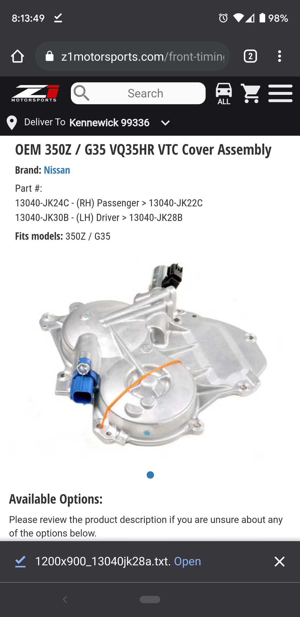

Just to verify you're trying to replace this part right?

Yes, that is the devil I am wrestling with. Any advice for the removal of bolt #8. I am going to take off the power steering pump and then the iron mounting bracket because the pulley tensioning bracket is mounted behind that iron bracket and covering bolt #8. I sure could use some advice on this. Thanks for responding. To make matters worse the lower bolt mounting on the power steering pump is so long that it cannot be removed without pulling the fans. Ugh. It doesn't look like I can get to the two bolts holding the iron bracket to the block.

Fortunately the fans are easy to remove. I have very little experience working on the HR motor so maybe someone else can chime in with tips on removing that piece.
