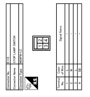

Well this is interesting

It's probably your parking lights that flash with the fob, not the brake lights. Unplug the brake pedal brake light harness (make sure it's the brake light harness and not the one for the cruise control) and see if you have voltage. At least then you will know which direction the problem is.
Hey, Thanks for the response! I didn't think I was going to get one after a couple of days. Yeah, at first they were the taillights but it's 100% the brake lights. The taillights are the outer ring of lights that stay on with the headlamps when switch on. The brakes to my understanding are the innermost lights. As far as "unplugging the brake pedal light" do you mean the brake light switch from the harness? If that's the case I'm assuming the car doesn't have to be on to get that voltage reading. And what kind of reading am I looking for voltage-wise?
So, I removed the brake light switch and checked the harness with a voltage tester "voltage light". With the accessories on just in case, I got nothing on any of the connections. Took it a step further and went to the brake light relay and saw that I'm not getting anything on that harness either.

Make sure it's the correct switch on the brake pedal, there are two and I THINK the brake light switch is the one at the top. It's a 4 wire harness and pin 1 should be hot full time regardless if ignition position (brake lights should work ALL the time no exceptions).
If you don't have 12vdc on pin 1 then go to the cabin Fuse Block - J/B that's also in the driver seat footwell and check fuse 7 (10 amp) for power.

You were right., but that wasn't the issue. Turns out there was a loose connection in the back of the harness that connects to the brake switch.
