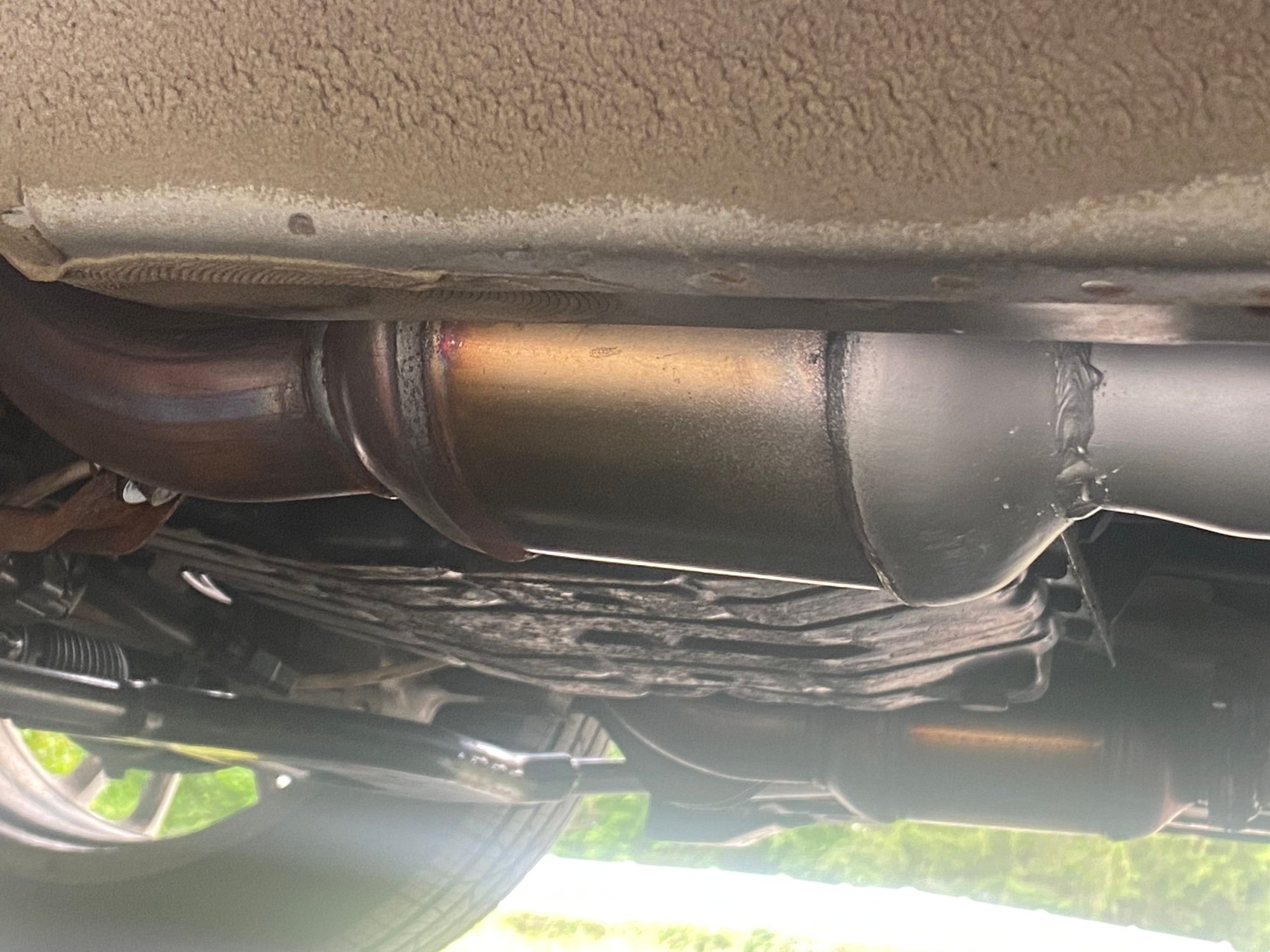

Ended up fixing the code brought my car to an exhaust shop and had them weld a section of my cat to my ypipe. Light went away on it’s own after driving like 300 miles.
The connection between the gaskets and cats was noticeably loose and off place on that side specifically. They recommended the other side same thing but I let it because it looked good for now.
