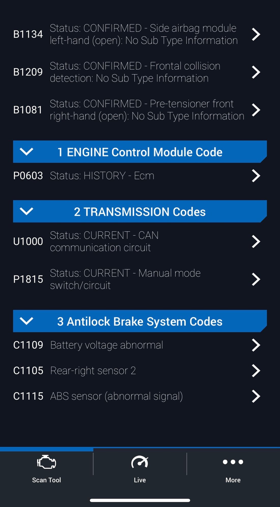

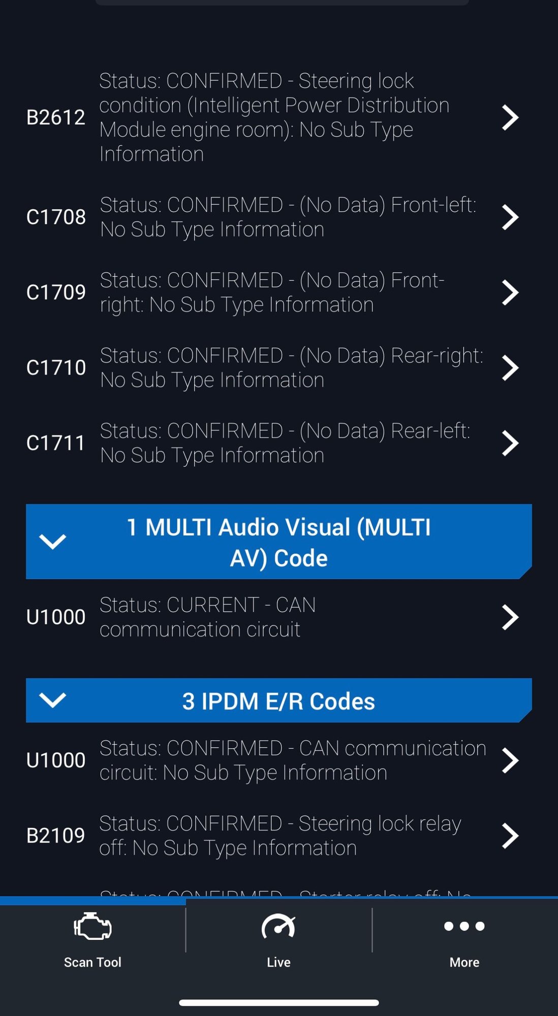

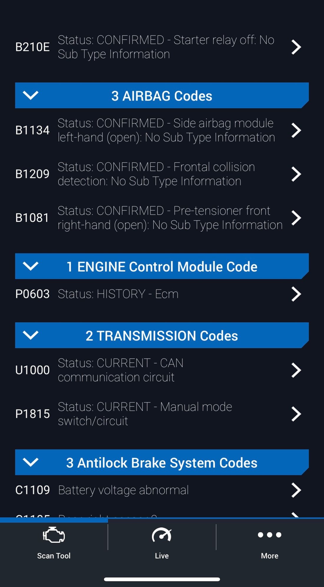

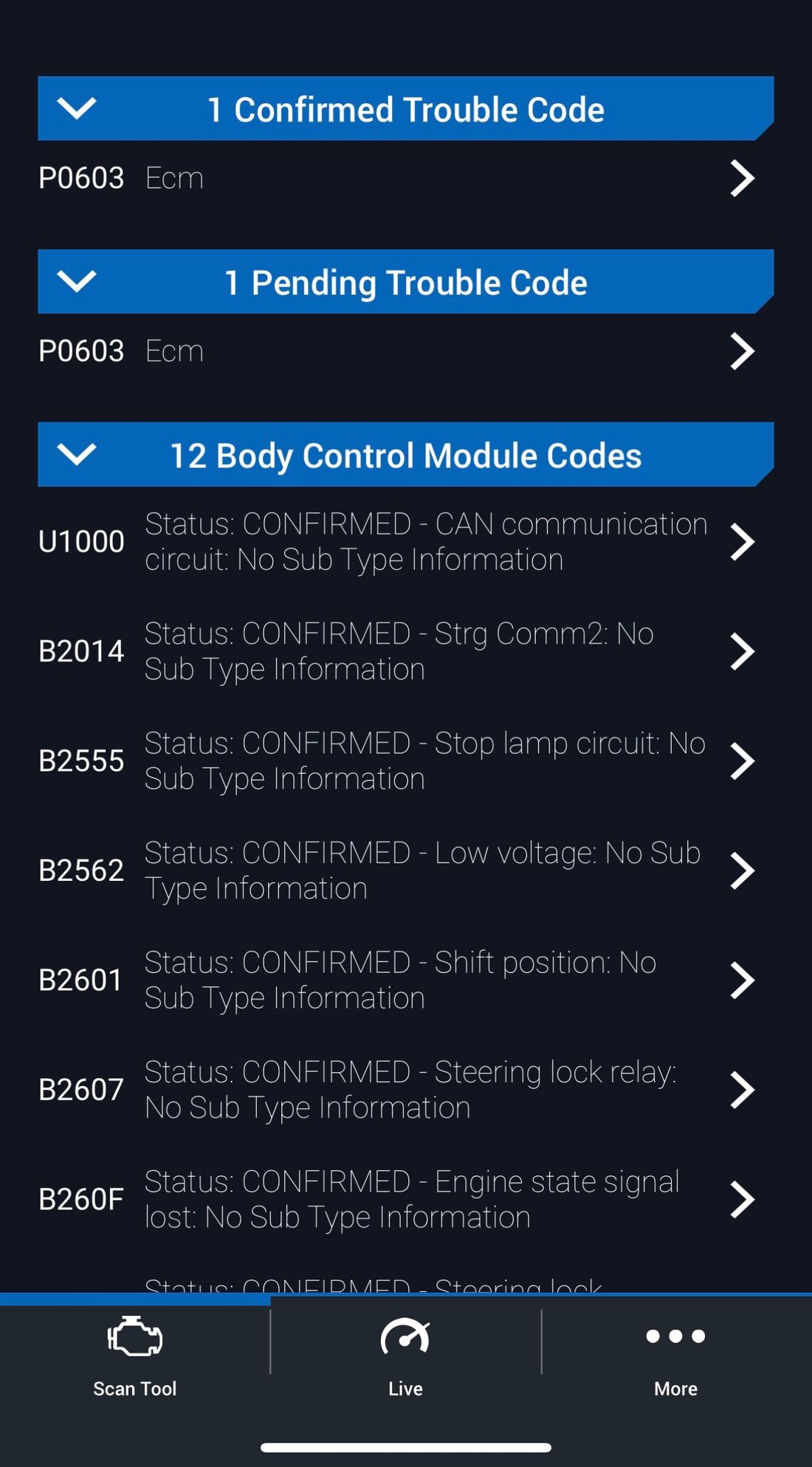

These are the codes it gave me, when I disconnected the alternator the car runs fine.
Old Jun 18, 2023 | 11:08 AM
cleric670's Avatar
BANNED!!!
Joined: May 2017
Posts: 14,837
Likes: 2,497
From: Washington State
Coupe 6MT Premium RAS
Pretty sure you blew a fuse in the fusible link. U1000 means one of the computers isn't communicating, I'm guessing the ABS/TCS computer since you're also throwing a mountain of codes for it.
A lot of those codes are probably just cascades from having low voltage.
Verify the voltage is around 14.5 volts with the alternator plugged in and the engine running. Wipe all codes, see what comes back.
