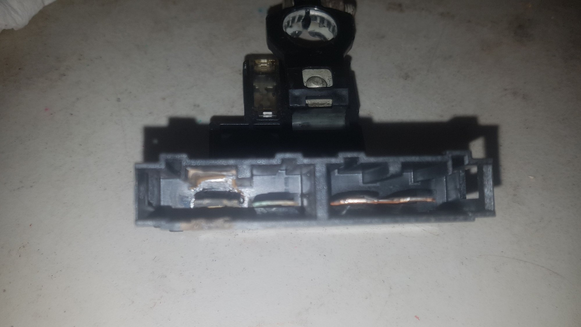

Skyline I am convinced it is that one upper terminal fusible link now. Suprisingly it is not very obvious it is blown. No break like normal fuse, no melted anything, no cloudiness. Although the 4 links on bottom in a row still have a somewhat shiny finish whereas the upper single has a slightly darker finish. Thing is, that is all it could be with what i ruled out. only a few options for 0 power and this is last! I am going to switch my cars link assembly with the new G which should tell the story. Thanks man.

OK, I've just learned something myself. The 120A link (the BIG one) is in fact just to the right of the single bolt nearest the battery + terminal. I think that is what you are describing as being slightly discolored? This would be a logical answer to the puzzle and the likely source of your problem.
I've found a couple pics somebody else posted of a blown one. Hard to see it's blown from the top but easy to see when lit from behind by a flashlight.
I only hope that the problem which blew the link in the first place has been resolved so you don't blow your NEW one...... Let us know.

I got this (yellow icon with key) & still wont turn on... i don't have any power in the vehicle except only the key fob slot - pushbutton & icon to step on the break pedal & push the button THEREFORE the icon on the mini screen disappears.. i check my 2 keys & change the battery my car engine battery good for 1 more year likewise i check all the fuses... i don't know nor read anything about the (positive terminal fuses) i won't go that far to touch it = due to i do do NOT any other problem... praying i kindly respectfully get a response/advice... thank you
On the far left side picture to connect looks like it's burnt 🤦‍♂️
On the fuse 100a (far right) is not silver not crack only in bluish burnt color
